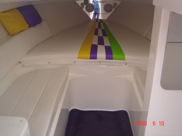

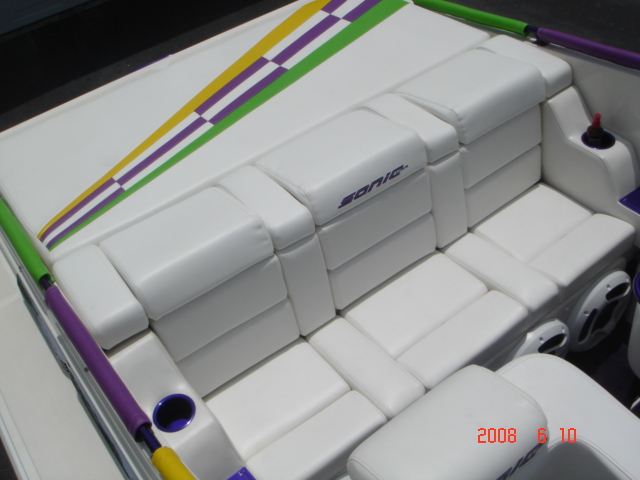

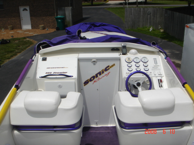

Ive been on both boats. The sonic has more room in the cabin.
They have about the same room for passengers. My boat had the 35 to 50 mph bounce that you here people talk about when it had the stock 496 HO but with the 525 it dont do it.
