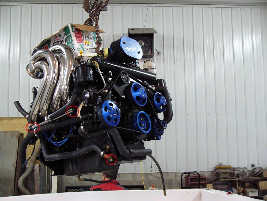

My 2006 525 EFI ...6 plug ...three on this side

I know this is a bit off topic, but stick with me. I just put a new set of CMI headers (OUCH) on my 525. Some of the fittings were different on the new headers ? I am told in about 2007 Mercury Racing decided there wasn't enough water going through the the headers. In short, I had to remove the (bypass) hoses from the header manifold to the tailpipe and plug both and drill out a restricter in the stb. side. I see in Christian's picture the bypass hose is still installed (left). I'm not sure witch engines this applies to so check with somebody knowledgeable for more info. Doug
