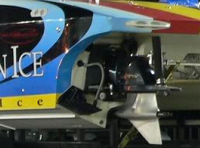

I've been told that so much i disabled our tunnel tab in the UP position...

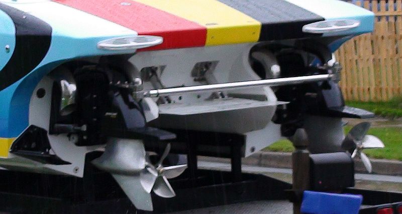

I will try that we have made functional the ballast tank with dump pumps on DOI.
Here is a picture of the hose that picks up the water from the machined tab. The tab was machined that way when we got it.
