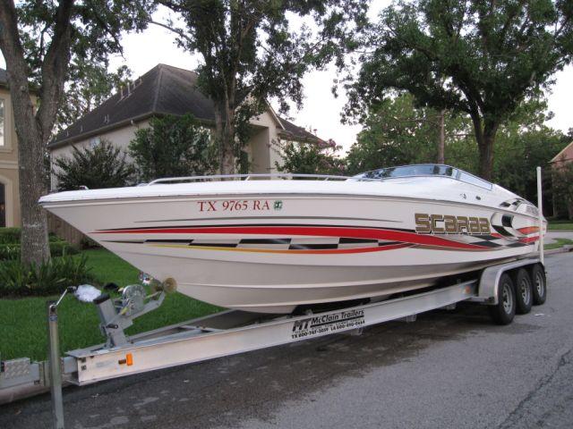

I owned a 29 Scarab with a single big block. A friend of mine has one with twins (and is for sale in Austin, TX). The answer is they are both great boats. If you find the boat you like, either engine package is fine. This is one of the best handling, and most fun boats that I have ever owned. It looks great, easy to tow, and has a decent cuddy. If you want a great boat in the 30-40K range, you can't beat one of these! Pictures are of the one for sale. Good luck with your search...
