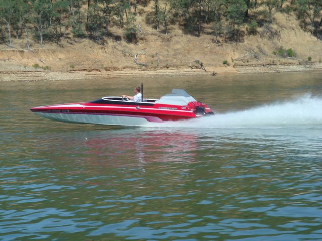

By the time you buy new exhaust (you'll find none for SB's used) buy steel cranks and tough recip assemblies, good heads, and a good roller cam, all the marinizing pieces sea, pump etc. (good luck finding a single belt kit for a small block that will work) all the accessories are no cheaper than a big block
You need to walk a much finer line between idle quality and power output (head size and cam selection are more critiical for good manners) with a SB just because more cubes make for better manners all around.
After you are all done you'll have spent about what you'd spend on a big block.
My 406 in my little boat rocks balls, but it was no cheaper and a bunch harder to do than a bbc.
