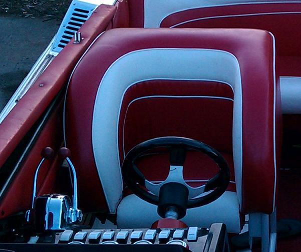

You mean like these As Ted mentioned earlier they are no problem to throttle.
I have had twin zero efforts for about 5 years that I plan on installing but I can't seem to justify buying the 4 plastic cable ends for $43ea. I will probably make some this summer and install them. Can't wait for the new throttles!
