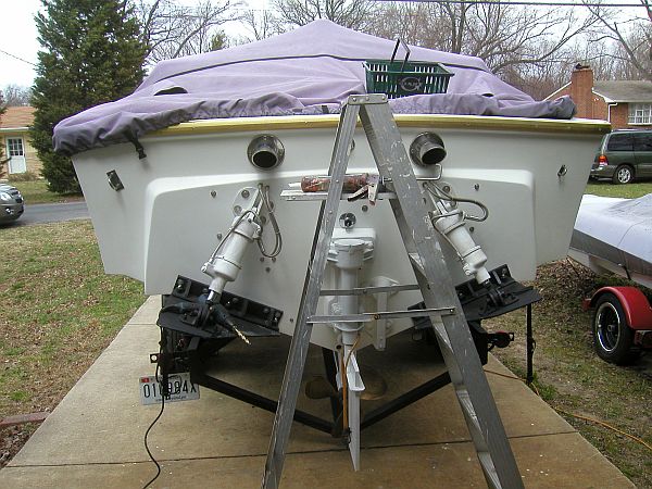

The same sound comes out if your tips are 2"s or two feet. The thing to think about like the boat above is if you gunnels hang over the transom. I'm sure that deflects noise down and away from the cockpit. Longer pipes would lessens the deflection.

Never thought about it cause I wouldn't do it.
Even on the 24 with it's exhaust as high as it is still has internal rubber flapper 6"s inside the tip.
Have friends with jet and flat bottom boats. They run dry and wet headers over the transom. The wet are louder then most inboard wet exhaust because they introduce the water at the very end of the outlet and they don't run flappers.
Flappers keep the noise down some at slow speeds because it lets a little water build up and slows down the exhaust and quiets it as the exhaust gasses has to push the water out and the flapper open (loosing energy) at the same time. Once you get into the throttle it makes no difference. Now it just depends on how far down stream you introduce the water.
Also I will never use those internal metal flappers with the bar across the middle again. They drove me nuts. I would be working on the boat or something with the motor running and when you were at just the right angle you would hear what sounded like a bottom end knock. They thumped all the time when at idle anyway but at just the right angle to the motor it would scare the crap out of you. And once you can pick out a noise but then with the motor cover closed I would run a little hard and come back to idle and hear it thinking please be those stupid flappers. One day I walked out with a sawzaw and a long blade and chopped those SOB's out. Put 2 of the rubber caps on the ends and never been happier.
