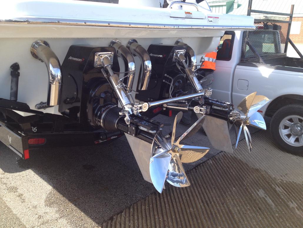

here is a link to my boat with the Arneson 7M conversion. http://47excalibur.com/ ... final prop size ended up being 20'' x 27 x 18* when the props were 22'' it jumped up on plane but hurt my top end. cut them down to 20'' and now its perfect. sounds like you dont have enough torque in those motors and need the vent tubes to help out...but getting on plane make sure the drives are straight out bc if there in the down position you will never get her up
