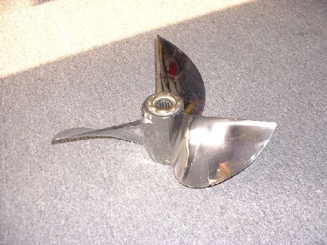

Most of them are designed to be surfaced, which means they are used on high x-dimension I/Os, surface drives, and of course, outboards.
