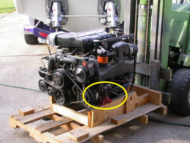

Old 09-24-2014 | 12:54 PM
Joined: Sep 2014
Posts: 396
Likes: 29
From: Patuxent River, Maryland
Hi Folks! Just to verify, is it correct that this is where i should jam in the hose on each side of the motor to back flush? (well thats what i did last weekend, although i didnt see anything come out of the hose which usually clamps to the outflow side of the water pump)
Thinking about it further, i suppose that i should also block off the hose on the frontside of the motor which goes to the opposite side of the block (where the stream splits to flow to both sides) so that all pressure is pushing material back towards the water pump, would that be correct? (see photo below)
Am i on the right track here?
Thanks for the advice!

Old 09-24-2014 | 09:43 PM
Wobble's Avatar
SORE MEMBER
Joined: Apr 2004
Posts: 6,984
From: 29°50'49.74"N 95° 5'17.55"W.......TEXAS
Just follow the hose from the sea water pump to the first cooler (most likely power steering) pull the hose off both sides and flush through the cooler, you may have to use a tie-wrap to dislodge some pieces. Big rubber pieces wont get past the first cooler.

Old 09-24-2014 | 10:01 PM
Joined: Sep 2014
Posts: 396
Likes: 29
Ok i'll have to take another look. I tried tracing where the hose out of the pump leads to but it couldn't tell with absolute certainty (hard to see under the block)... although It seemed to me that it ran next to a fitting on the very back of the block near the transom. Is there any reason why its not just as good if I'm pushing the water from further down the line? Reduced pressure perhaps?
