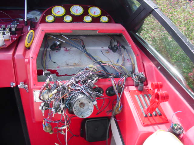

I used to do central office telecom install so I had a little practice making things look decent. Re-wired the entire boat, only re-used the 9-pin harness, it took a long time and was expensive. All the different color wires to keep things straight. Or if you are really good you can do everything in black and white as long as you label everything. Rough everything in that you will need, then pretty up the helm and work out.
One other suggestion is to use the drill trick to twist the +12/GND together for say your blowers, bilge pumpts, etc and run all your grounds back to the helm to a bus bar. Makes it easier and keeps it tidier. And lots of ty-wraps and cushion clamps.
