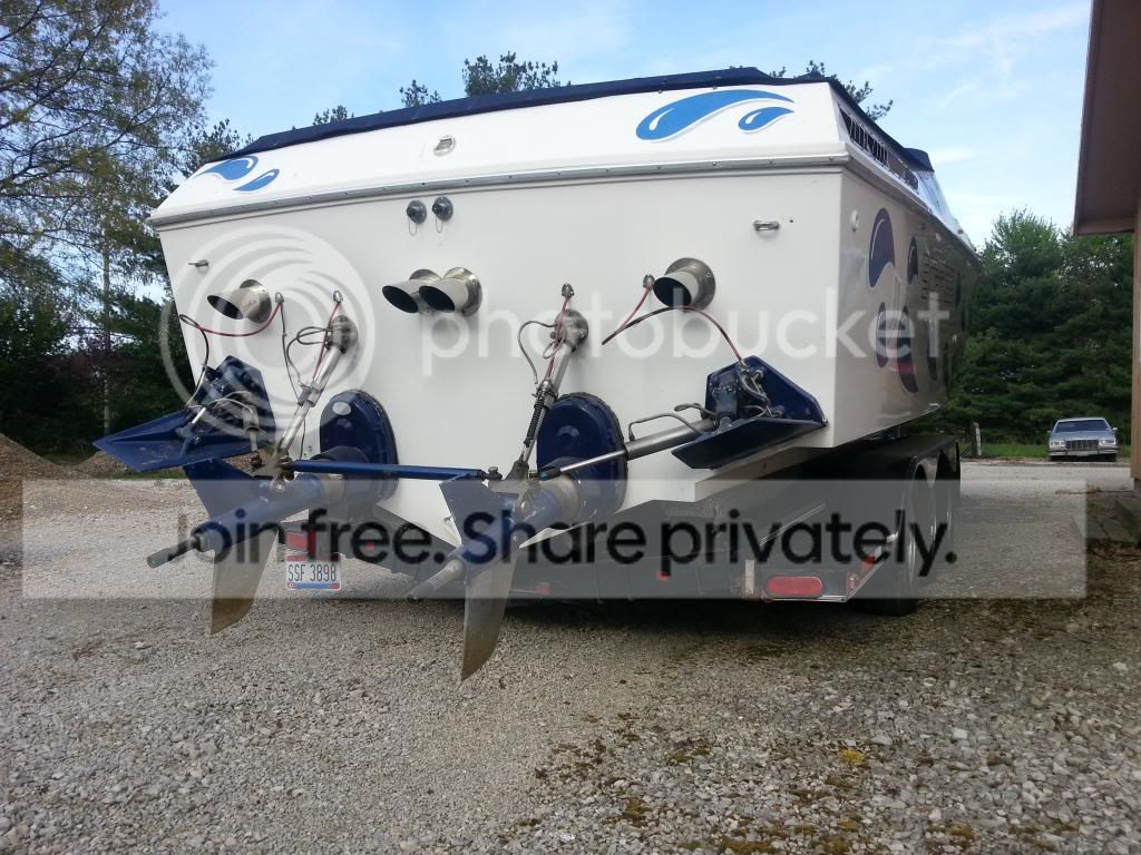

Never saw a Scarab III with arnesons. I'd like to see some pics of that setup.

Thanks Thunder. I will post some pictures when i get home. On the work computer at the moment. Any pictures you guys have to share would be great too. Is there a molded hose that runs from sea pump to the crossover. My sea pump is mounted on starboard side of the engine than the cross over pipe comes out towards the port side
