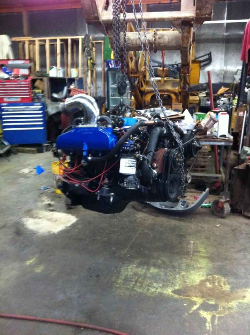

i pulled the engine out and was pleasantly surprised to find a 4 bolt block. all the research i had done said 330s were 2 bolt. the heads were peanut ports, flat top cast pistons, 3/8s rods, a cast crank, flat tappet cam. all of that was expected. two of the lifter bores were starting to mess up so im glad i pulled it out.
that high lift is not what i used to pull the engine btw. it just happens to look like it. thats from somone who couldnt pay a bill so that was given to us in exchange. the engines was locked up and im rebuilding that too to rebuild and sell.
