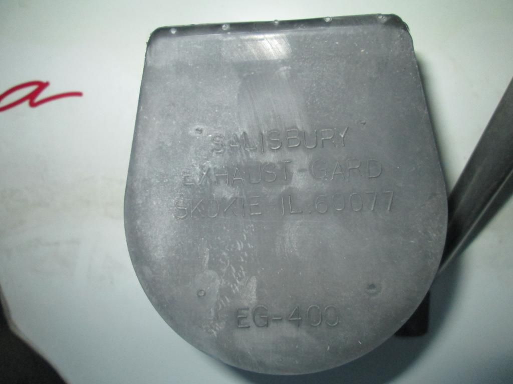

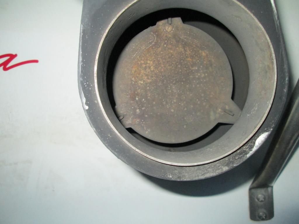

I just bought this Baja Outlaw with a 454 mag and its a little too quiet for my liking. what can I do to open it up a little without sacrificing my engines life? right now it has quick and quiet mufflers with a crossover. the tips have a rubber flapper and up inside I can see some sort of a baffle. I would like more sound but I am new to these kind of boats and a afraid of water entering the motor through the exhaust.

Long as the flapper is in place you don't have to worry about getting water in the exhaust. I have the baffle I could put in my exhaust but I don't unless get on a lake with a restriction. My baffles bolt in so it does not take much to put in or remove. I'm not real sure how your are locked in place.

The rubber flaps will help prevent water from going up the exhaust to the motor when you launch it at the ramp. You will definitely get a louder sound if you cut out the baffles inside the mufflers. A previous owner of my boat did just that and I think it sounds pretty good. But the captains call or quick and quiet definitely has its advantages when you want to have a conversation onboard.

Not true. Those flappers can wear out, as well as blow off when running, and you would never know it. If removing the mufflers & H-pipe; I'd advise installing new exhaust tips with internal flappers as well.
