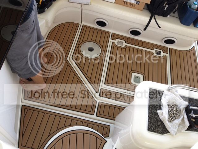

I am seriously contemplating installing a Teak look SeaDeck floor in my Concept 30'. My question to those with experience with SeaDek, if I provide SeaDek with an accurate template, does it require any special skills to install? Also any special prep. Right now my floor has a raised coin texture. It is not the rubberized Loncoin but is gelcoated fiberglass but looks like loncoin. I have a piece of SeaDek on the motor bracket and it seems to hold up to traffic and the color appears to not have faded. What expectations should I have in regards to easy of cleaning, is there much color fade on the Teak look? Any other tips, suggestions, experience is appreciated. I have attached a photo of the style I am looking to go with.

[ATTACH=CONFIG]531498[/ATTACH]
Originally Posted by ICDEDPPL
Man id love to get that stuff for my swim platform, but with that design theres no way id get the measurements right.. boo
Call them see if they have a suggestion.... They were great to deal with when I used them
