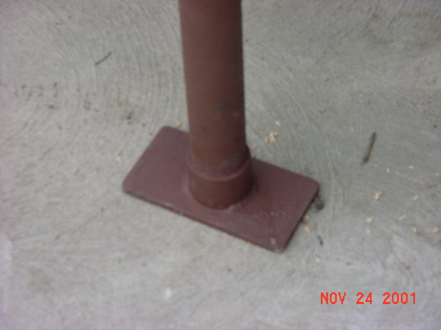

and the feet. Just took a little welding. It all unthreads and stores under my deck. Keep it over the boat all winter and pull the cover back when I need to hoist motors. Then pull the boat ahead and drop them on the stands.

Formula31,
Thanks for the pics. That's exactly what I'm looking for but I got to tell ya, it looks a little shaky. How stable is it? What do you use to do the actual lifting, chain hoist, come along etc? Can you move the motor side to side when installing to help line things up?
Old 09-20-2002 | 11:45 AM
formula31's Avatar
Joined: Mar 2001
Posts: 2,558
From: ohio
Its very stable after I added the 2x4 legs. I use a 1 ton chain fall and I have a trolley for the beam if I need to move side by side but ive never needed it. Its very easy to move the motor into place when its down near the mounts because of the amount of chain. Since my chain fall only has 10 ft of chain, I use a log chain to drop the chain fall down a ft or so so it will go all the way down to the engine stand mounts without running out of chain. I used a u-bolt to lock the cross member 2x4 into the upright 2" pipe and that keep everything very solid.
