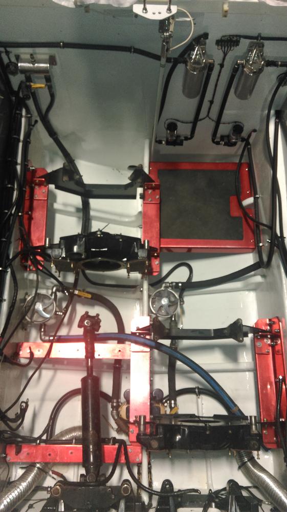

Ok. I'm coming up with 82 from transom to forward bulkhead, 16 from transom to rear motor mount plate of rear engine, 34 3/4 from rear motor plate of rear engine to rear plate of front engine and 31 1/2 from rear motor plate of front engine to forward bulkhead. Measured as close as I could to crankshaft centerline. I couldn't measure directly on top of the stringers because all the mounts were in the way. It's 53 wide from stringer to stringer. Also just as info I have 67 of cockpit space.

Thanks. Engines are being gone through right now. Would have been done by now but I spent the last 3 weeks looking for blowers and deciding if I could afford them. They won't be blown. Rick- with my engines the first interference you would encounter when trying to get them closer together front to rear would be the front engines bellhousing cooler fittings coming in contact with the rear engines alternator. Not using the cooler on that side would gain a little. Finding somewhere else to mount the alternator would gain more.

Thanks BCK . Good to know , currently I don't run bell housings with in the integrated coolers so that might be a small advantage and relocating the alternater shouldn't be that difficult . Great info .
