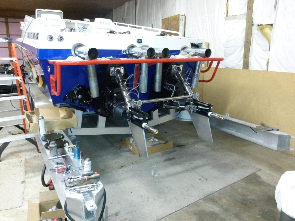

Tibbe made the decision to purchase the Arneson #7M Kits. He sold off his current outdrives, HP transom assemblies, extension boxes, and steering first and recovered a considerable amount of money back towards the purchase of the Arnesons reducing the overall cost for the conversion.

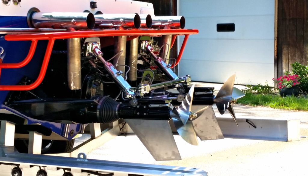

After working on the conversion to Arnesons Tibbe put the boat in the water for his 2015 boating season debut on Saturday June, 6th and things went GREAT. Adjusting to the different style the cleaver propellers require to get on plane, Tibbe quickly mastered the techniques and ran the boat in the rough Lake Michigan waters. “The leverage the drives have on the boat was a huge improvement that I wasn’t expecting. With side by side engines, I was used to the boat acting stern-heavy in waves, the boat now acts balanced almost as if the engines were staggered. The boat rides on rails and is always predicable – I have all the benefits I heard about with Arnesons with none of the perceived issues.” Jeff’s wife Meg was surprised at the difference in the boat: “When we decided to make the Arneson conversion, after so many frustrations with our previous drives, I was seriously AMAZED at the difference in how the Active Thunder handles and carries on the water. Any fears I originally had with traveling well over 90 on the water have diminished, which is a fantastic feeling.”
Although Tibbe has only tried one set of props so far, the results are already proving out. The boat has gained 15mph of everyday speed with a few extra mph in the right conditions. Results couldn’t be better. Steering is great, handling is great, and no significant difference in docking. Did we mention he now goes FASTER too! “The Arneson conversion has brought me back from worrying every time I touch the throttles about drive gears to enjoying the boat and just being on the water.”

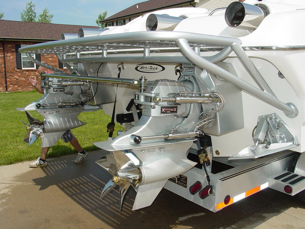

We took a 3600 Nor-tech SC from a 525 EFI, Bravo XR with boxes and upgraded to 775 HP with IMCO SCX's. The speed increased from mid 90's to 109 mph but the boat was a lot to handle above 100 mph becoming a drivers boat that without notice would bow steer so bad that pulling out of the throttles was the only way to save it. We found this was caused by the larger SCX lower dragging (acting like a tab) in the water with the centerline being 1 5/8" above the bottom of the boat. This year we decided to switch the boat to Arneson drives. We set the boat up with the props turning out because that was how the boat came with XR's and mixed answers about which was better. The first test drive was short as the boat felt a little loose above 100 mph and a oil line issue with the starboard engine. We switched the drives to turn in and retested the boat. This test took us to the 120 mark with a feeling that the boat was on rails something I have never felt in a V hull at top speed. It was the most fun I have ever had with my clothes on giving me back the "I can't wait to go boating" feeling I had lost several year ago. 3rd time out I bought the boat.
Nice, Brian! For me the SCX drives turned outward was pretty much on rails, inward was a bit loose, but there was porpoising in the 3000-3400 range with both directions of rotation. Just like bravo's the boat seemed very stern-heavy in waves. I had to run a lot of tab in rough water - killing even more speed.
The Arneson drives have no porpoising whatsoever (I've only run the boat with props turned inward), and I rarely use tabs except for slight adjustments in waves. I was also surprised at how well the boat handles and steers on plane, no difference from Bravo's.
