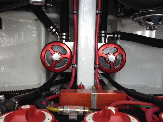

We mount them back to back on the center stringer and thru bolt them together and if you are going to thru hull water pickups I would install full flow ball valves just inside the water pickups.[ATTACH=CONFIG]550142[/ATTACH]

^^^^ Thats nice set up archer. I like the single screw top as opposed to nuts or wing nuts
I wish I had added the inline ball valve as I have limped back to the hoist on a few occasions as result of full strainer that I was doubtful to clear while I was still in the water..
