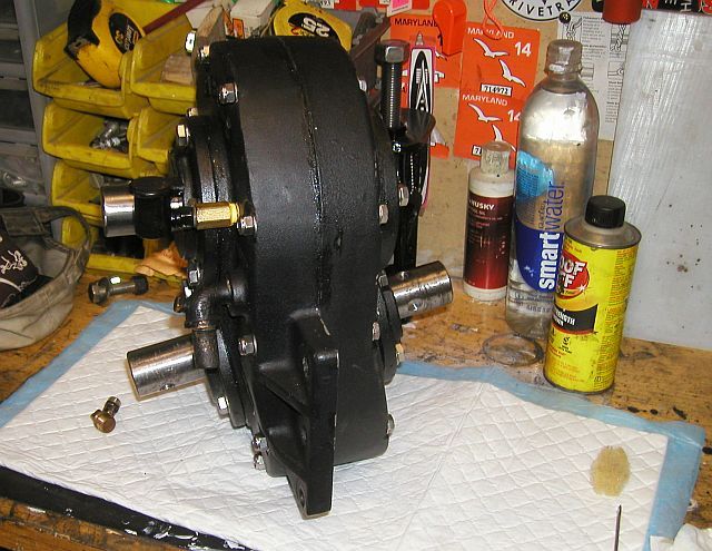

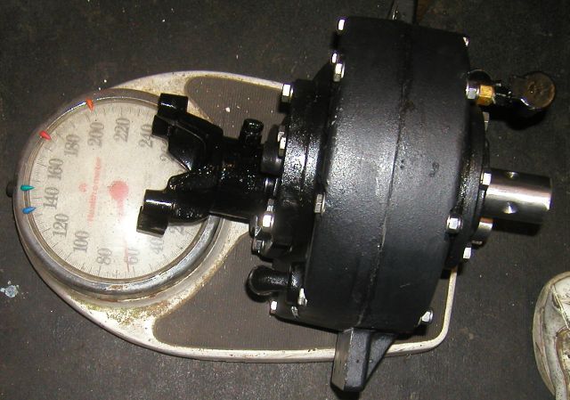

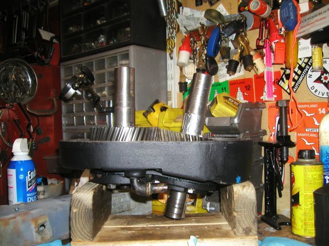

My V-drive is heavier then yours.
What you all are looking at is a 1967 Casale, C-1000 out of my race boat. All 64lbs of it. Makes my HallCraft in my Biesemeyer look like a paper weight. It is basically a (aluminum) V Drive but the bottom shaft that connects to the prop shaft actually goes all the way through the V Drive and out the back side to connect to another motor. That motor is basically a direct drive and the second motor is attached to the top shaft of the V Drive like a normal set up. Two motors into one V Drive to one prop. Saved about 4 to 6 mph from running a second set of running gear.
