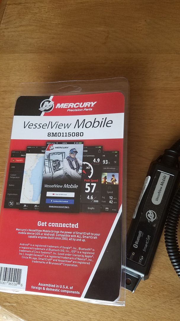

I'm looking forward to trying this bad boy out.
