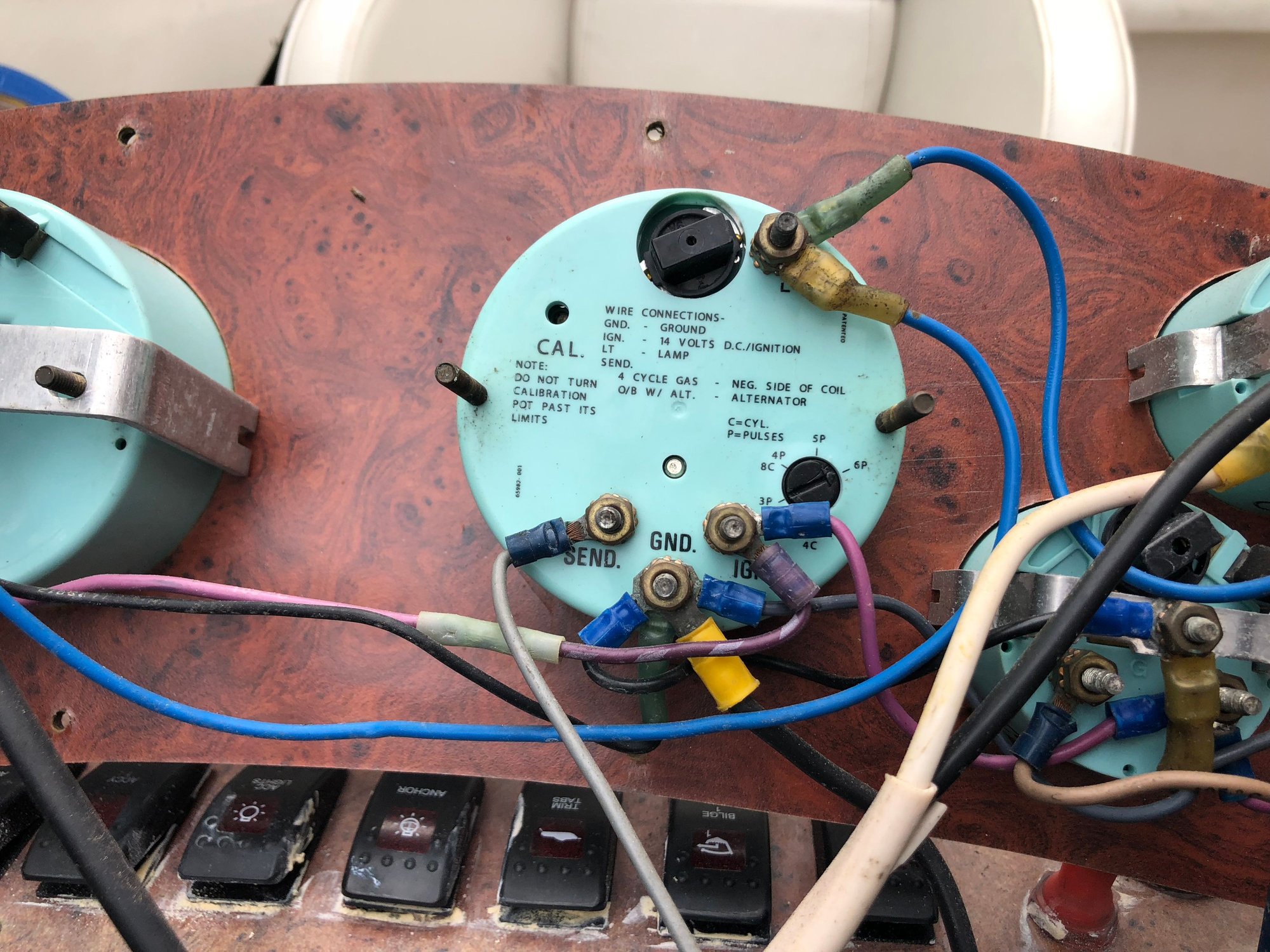

so you got me thinking here... can you guys tell if this tach is set right? I’m guessing I need to switch it to 4 pulses??
DBleil89 06-04-2018 10:48 AM
My quicksilver gauge with that back on a 2001 454 mpi is set on 4p. And it reads correct I checked it a tach/ timing light
BUP 06-04-2018 10:56 AM
on the back of the tach its called the pole setting. Has to be set to the correct pole / vs engine & cylinders --- also correct setting per outboard engine or inboard engine as many tachs are combo
SB 06-04-2018 11:25 AM
Well, the engine has Vortec heads (4 intake bolts per side + straight/up down) + edelbrock carb and intake.
Yes. change tach to 8 cyl/4 pole.

lol thanks SB, I was waiting for “some guy” to respond to the video. Thanks for the tip, I’ll fix the tach and check/change the plugs before I take her out again and then report back with the proper rpm.
