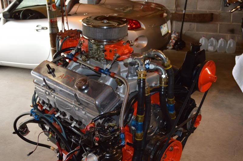

Good that it turned over. Compression test to make sure all is ok internally. 5.7l Merc 260? That's the stock engine in my 84 Challenger. IMO, don't waste effort repairing exhaust manifolds. No better way to ruin an engine if it ingests water. If your not looking for performance a set of replacement merc/glm manifolds/risers will work fine and last many years. Looking forward to your updates. Brings back great memories of working on my Challenger with my Father who has since passed. Enjoy every second of those moments!
I have 15 years of Hammond Challenger ownership and knowledge. Glad to help with any questions.

Last engine 383 SBC
