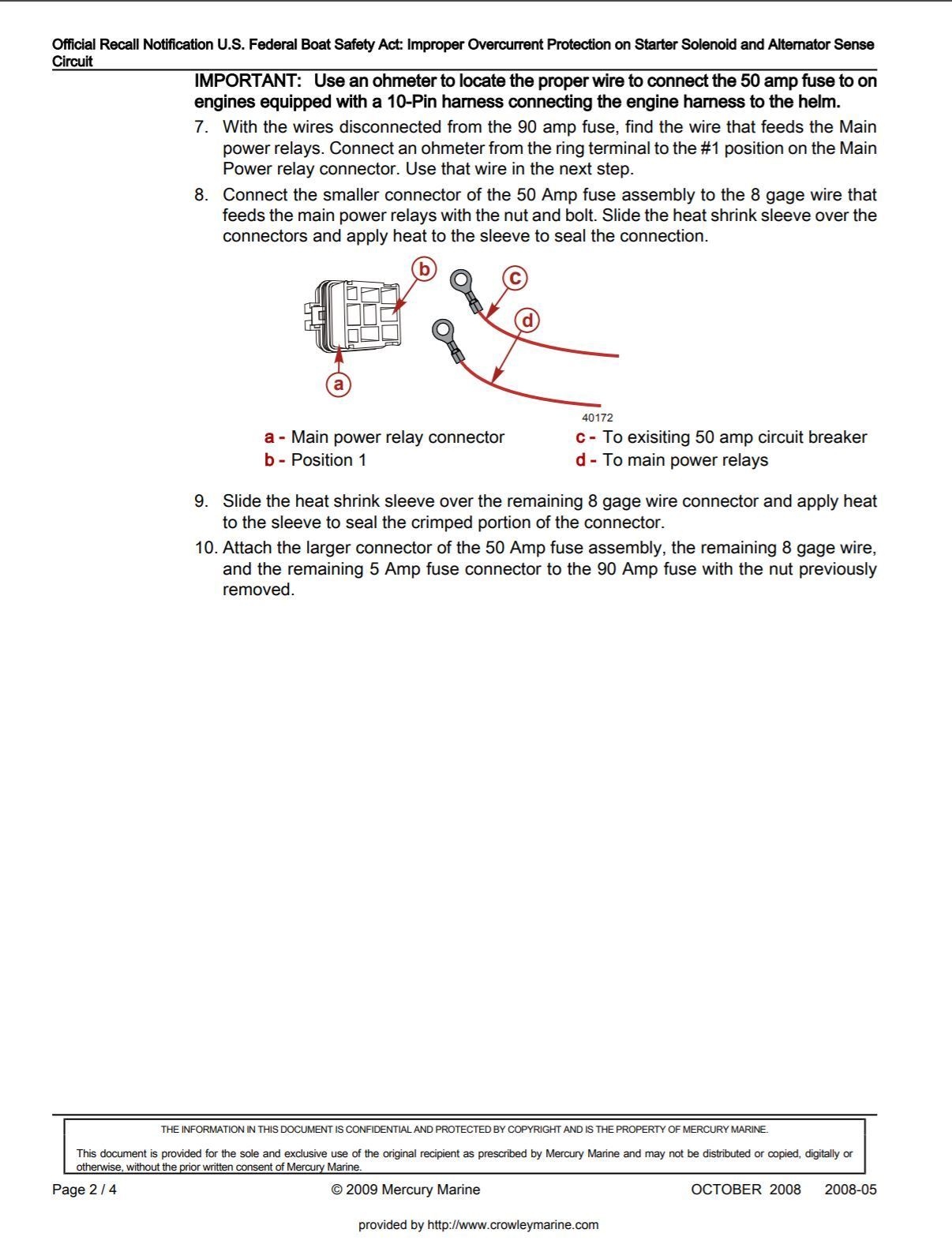

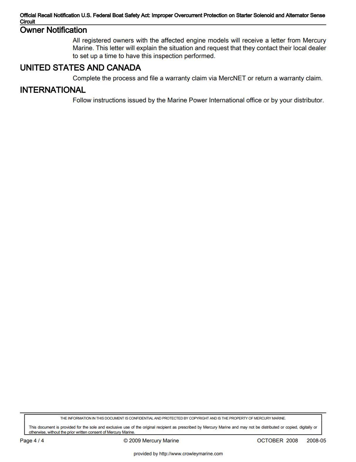

Found the bulletin for the Overcurrent Protection on Starter Solenoid and Alternator Sense Circuit
https://www.crowleymarine.com/sb/2/14300
