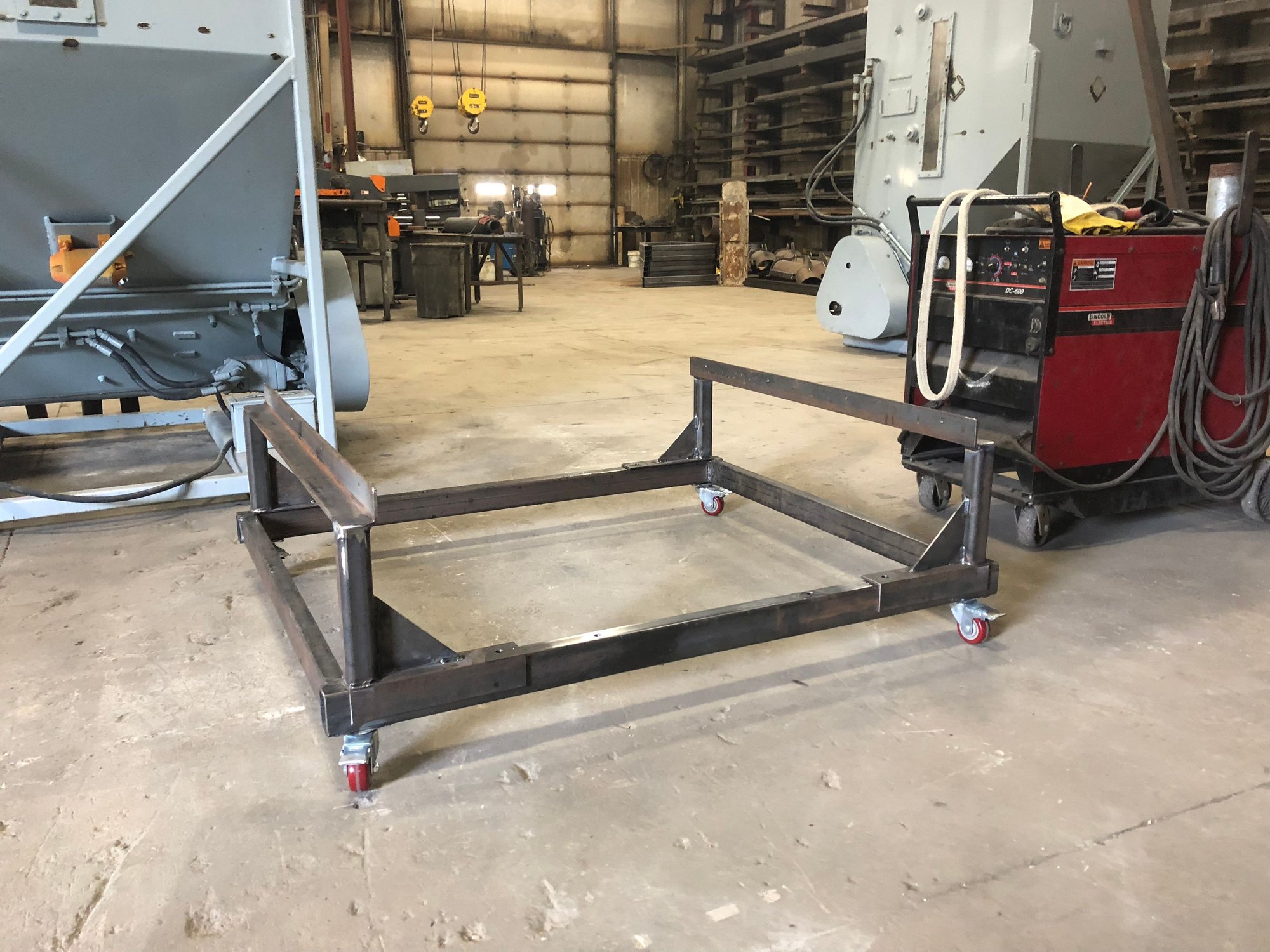

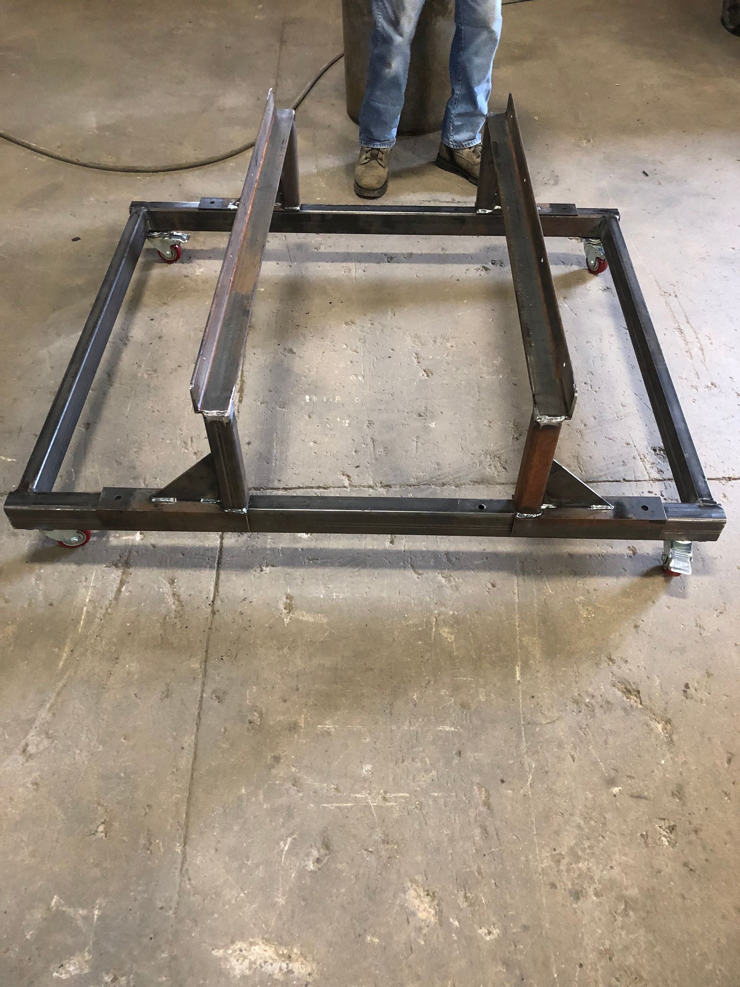

I built these thinking I could support by the strikes on the inside of the tunnel just as my trailer does. The uprights slide in and out on the bottom base / carts. I was going to use them to put the motors in the boat but seeing as it snows in Michigan and my trailer wasn’t completely finished yet so I kept it on the trailer while working on it this time around. I will use them when I go to finish the fab work then paint the trailer. Not sure if your still working on the boat.
Adjusted for 40’ classic tunnel width - should fit any cat
I don’t see why you couldn’t turn the uprights around 180* and use it on a V-Hull aswell
