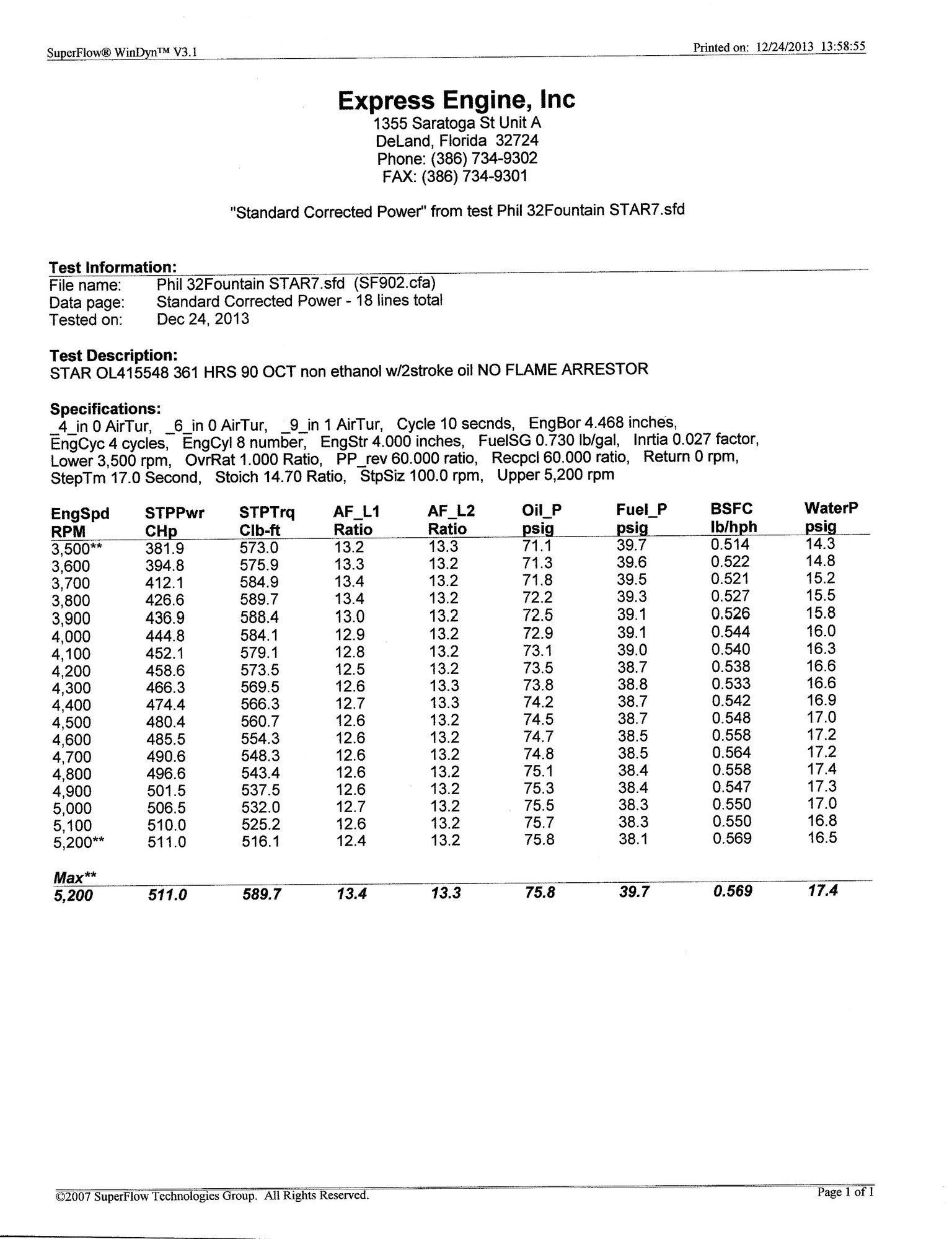

It depends on where you measure. At the prop they say 470.
Mine on the dyno with everything on them, water pump, sea pump, wet exhaust etc, corrected were right at 507-511HP.
This was at 380 ish hours, top ends had been rebuilt around 320-330.
EDIT: Mine are 2000, electric fuel pump only model.

Here are dyno numbers from totally stock HP500EFI and a stock 525. Same dyno, yes different years but interesting when you look at the curves. I should put into a spreadsheet and make a curve.
Also note this was before the injectors were cleaned and flowed on the 500's.
