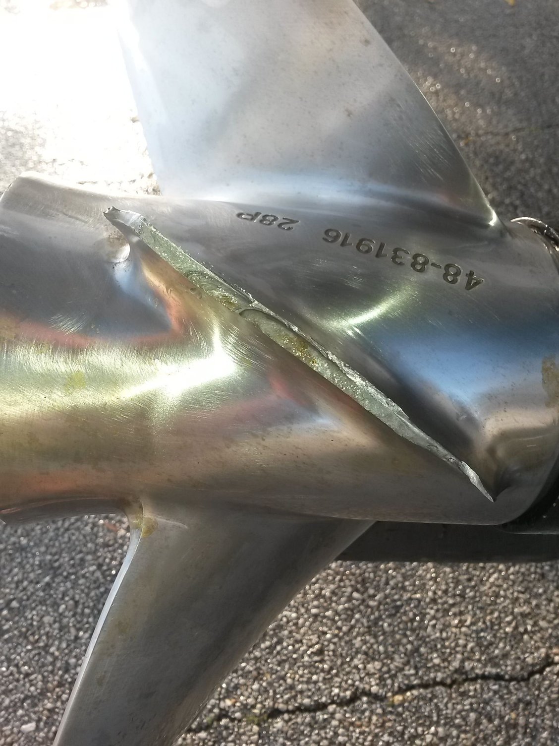

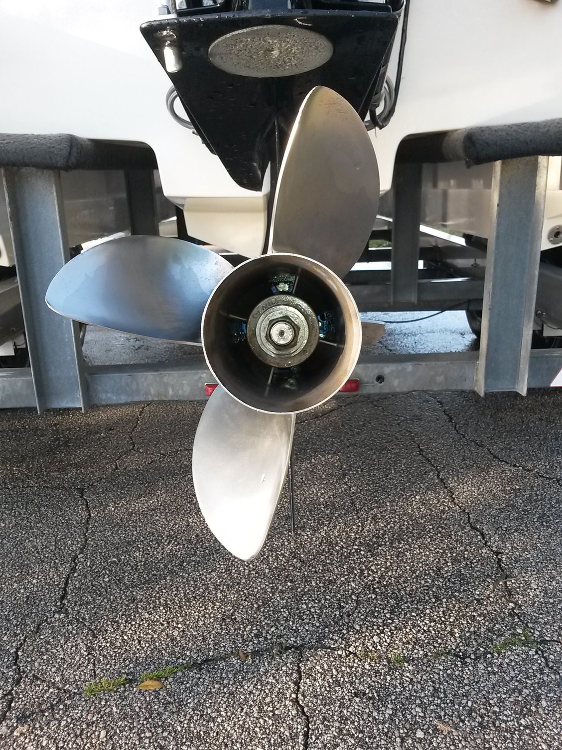

B38, how did you know the prop was cracked? Vibration, or did you see it while stopped?
B38 12-09-2018 08:36 PM
Noticed vibration and pulled back. Then when in reverse it went crazy vibration. Then I new something was wrong. Raised drives and could clearly see the crack .
