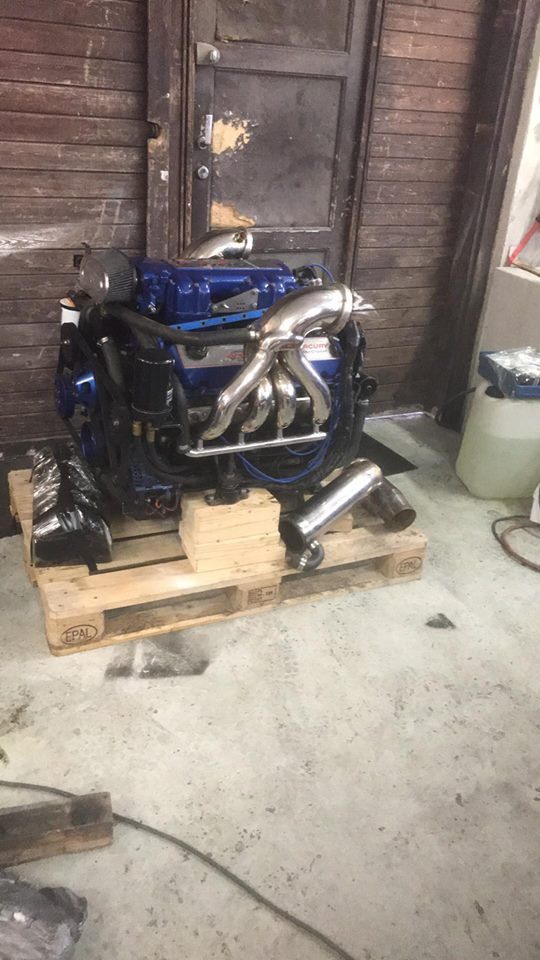

Old 12-01-2019 | 04:24 PM
Joined: Apr 2007
Posts: 533
From: Oslo
The engine before rebuilding ,)
