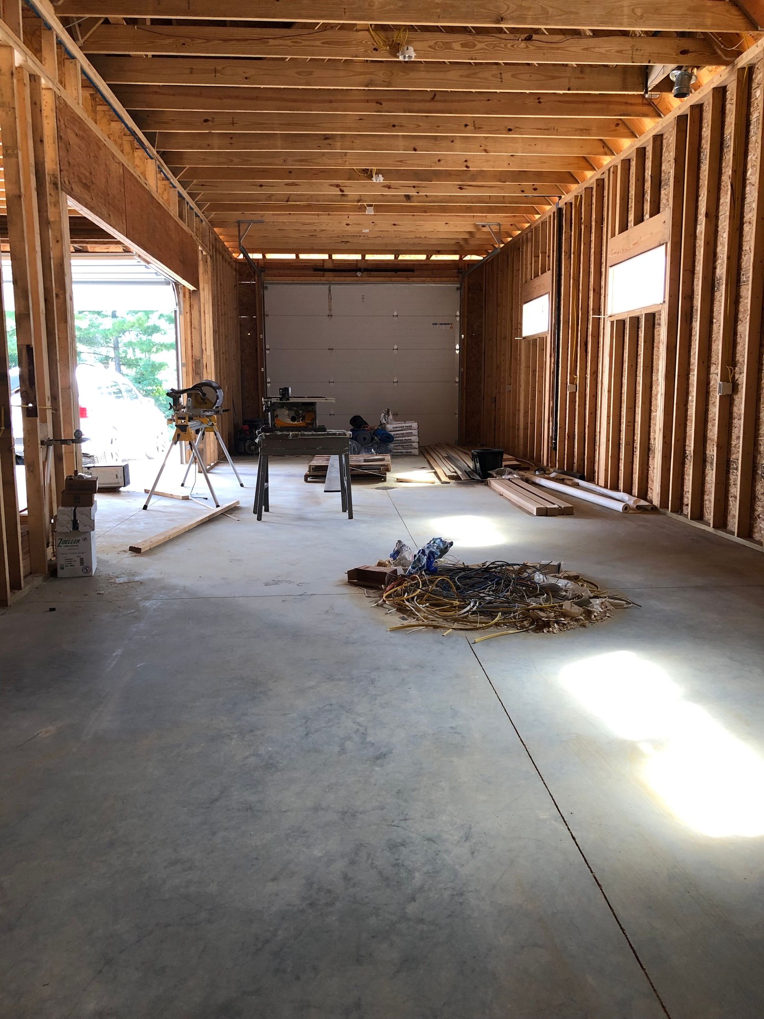

My wife said I can buy a cigarette but I had to build her a new house first. I had the house designed with a boat bay. It will have hot/cold water spigots and a sink. Shopping for tool chests now. Thinking of trying out a couple of 73" Icon tool cabinets. I originally had 14' ceiling to accommodate a 12' high door. It was framed up but once we saw it in person it ruined the exterior elevation on that side of the house. I had the framers take it down and re-frame it to 12' high ceilings. It now has a 10' high door (by 12' wide) That corner of the house looks much more appropriate now. One annoying consequence was that the builder forgot that I wanted 2 drains in this long bay. Instead he only put in one. it is sloped well so it will drain. Pisses me off every time I look at it but its not worth the cut and patch work that will be required to add it now.

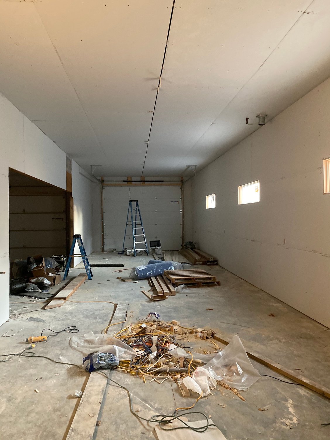

Why are there spacers in the sheetrock seam down the middle?
common practice to leave space for installation of expansion joint, but it would usually be installed every 30 ft., not necessarily dividing the room.
