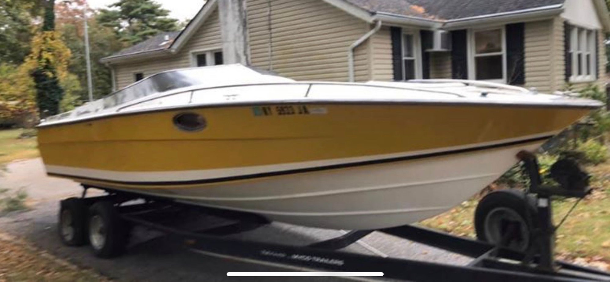

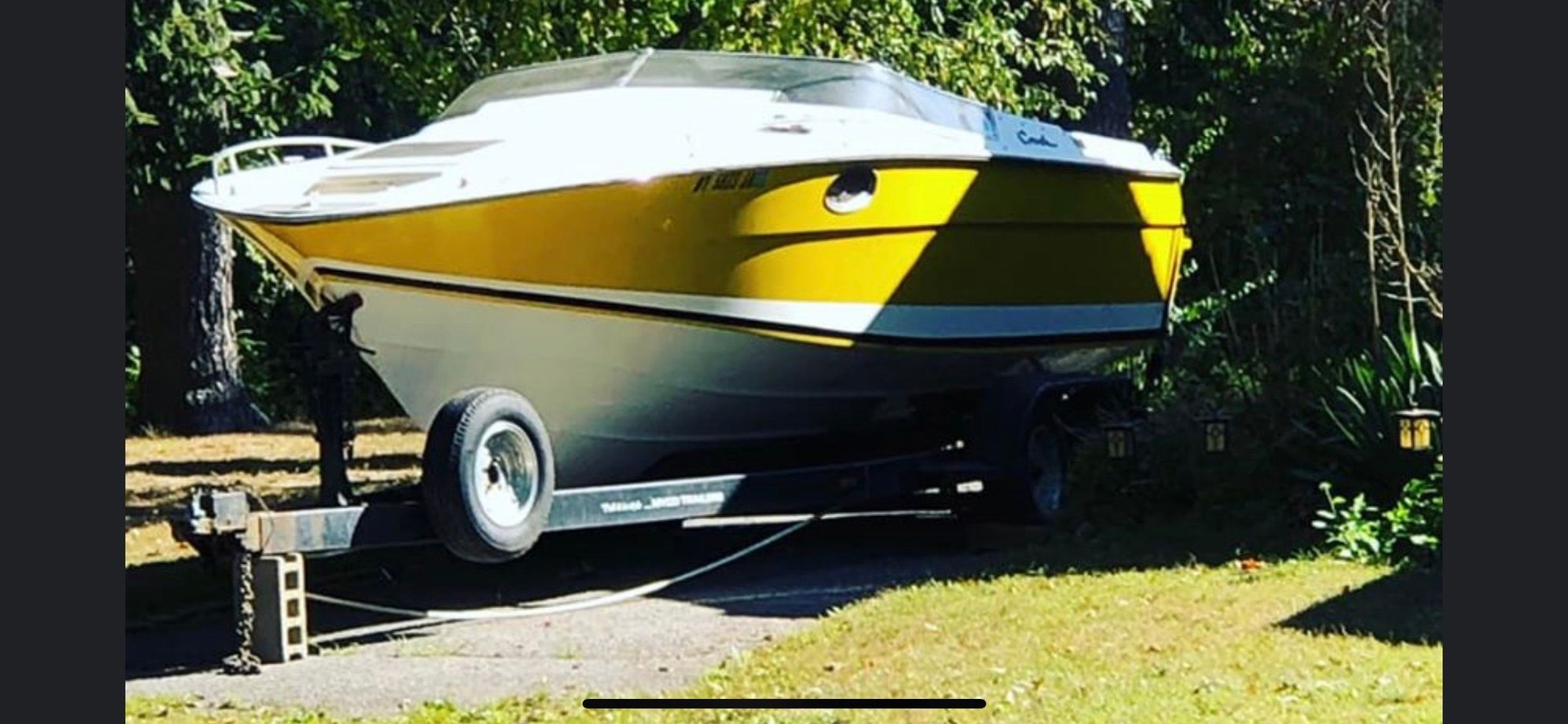

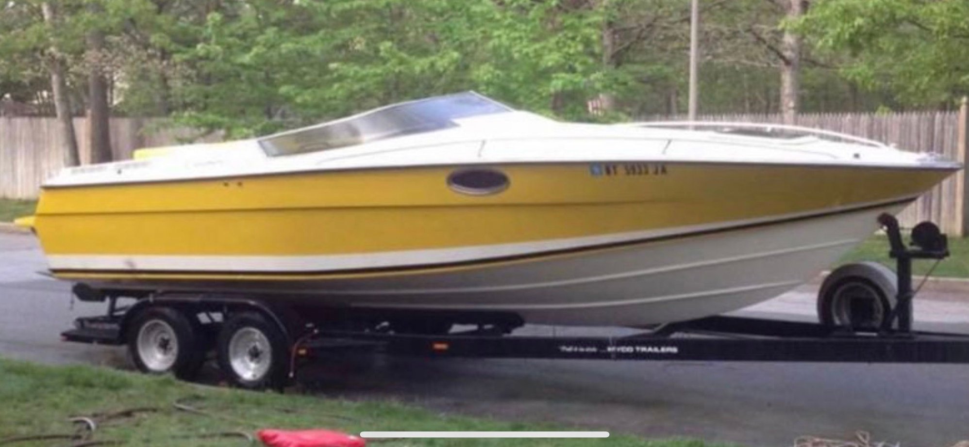

23’ Corsair 23 degree deadrise at transom
3900lbs.
500hp (installing soon).
Bravo 1 w/ 1.5 ratio.
I have a 21p stainless Mercury 3 blade that came with the B1 drive.
I bought this boat with no engine or drive and have no starting point.
This hull goes 58-60 with a stock 330 454.
Hoping for high 60’s with the new engine.
My engine is a hp500 clone with a slightly hotter cam and better heads.
