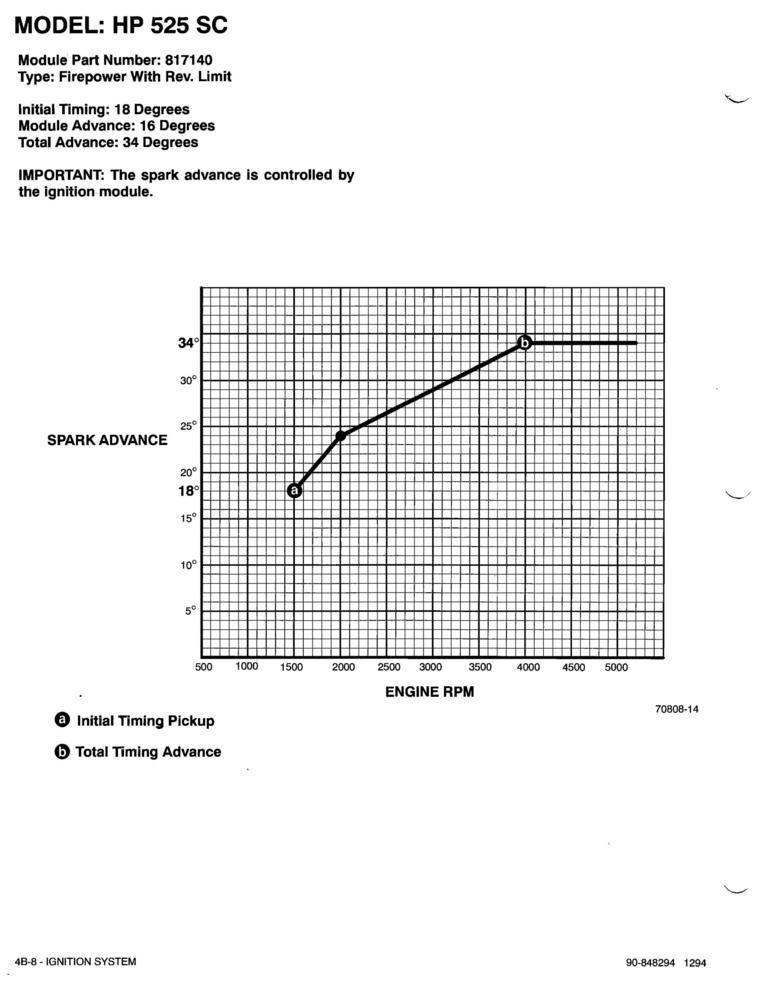

Just finished install on 525 SC. Timed it. 19degrees at idle and 35 degrees at 4500.

Why are you @ 19* base timing ?
That's what I read to set it at. What should it be?

Timing looks good, one degree more advanced than OE. I can't help with jets because mine had 850's on it. But jets do not play a role in starting, idling or throttle tip in. Not much to actually adjust, float levels while idling and idle mixture screws.

What timing advance system does it use ? not really familiar with this engine, but most BBC are timed around 8* at idle

More base timing than advance timing that seems weird, but learn something every day.......have you double checked the firing order , wires in the correct place,
