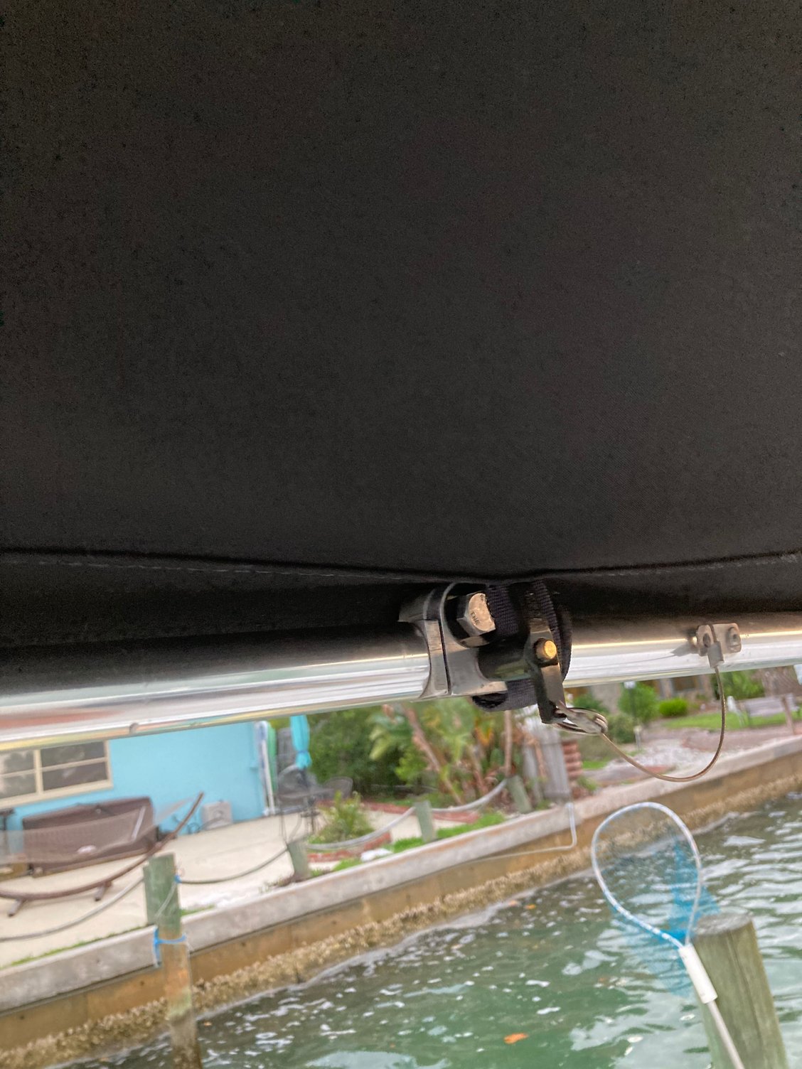

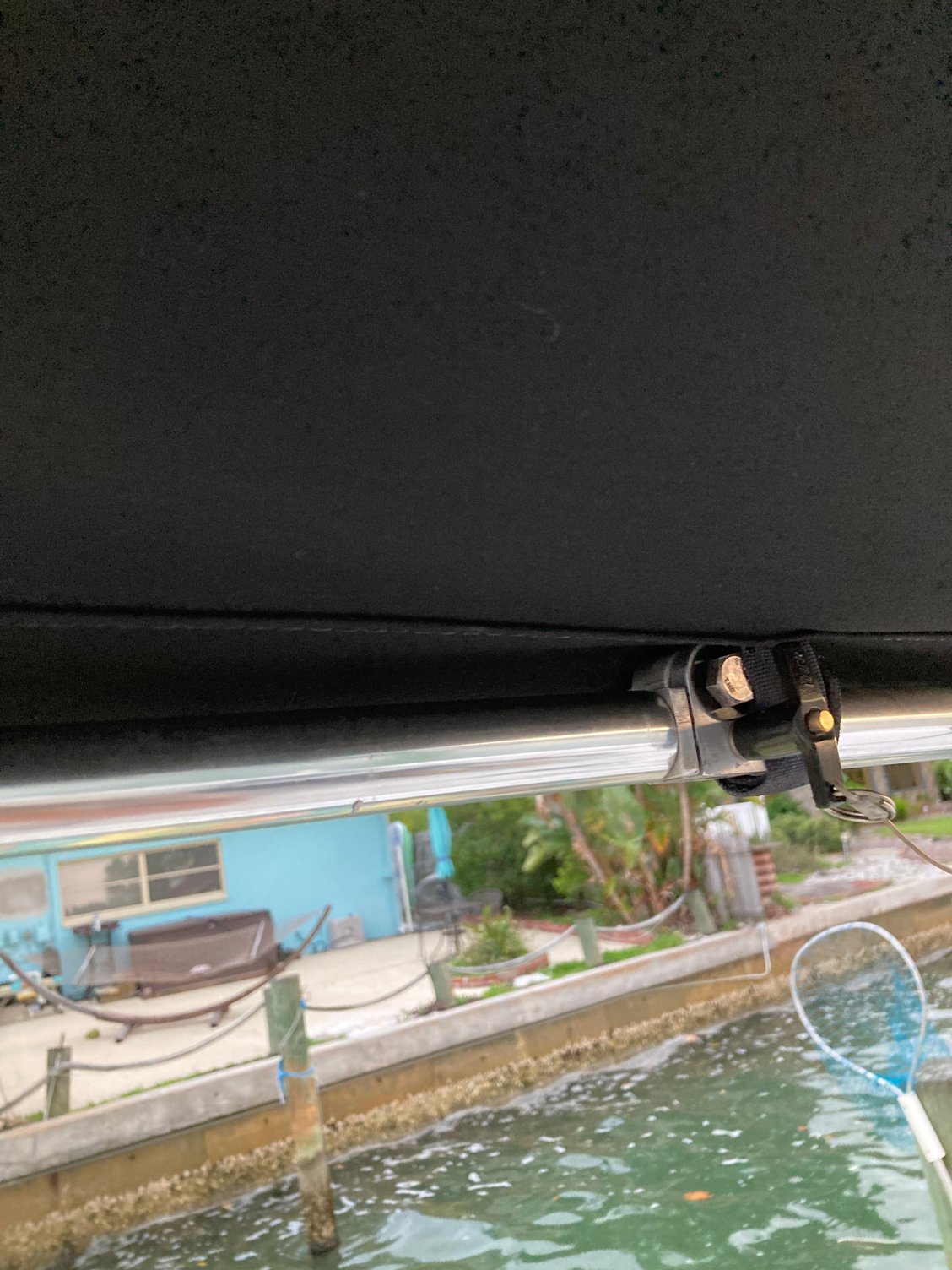

Reworked these hinges with bigger holes and push lock pins. Also got the top tuned up and tightened up. This is a total replacement from a couple years back, not totally perfect but nice enough and a requirement for Florida summers.

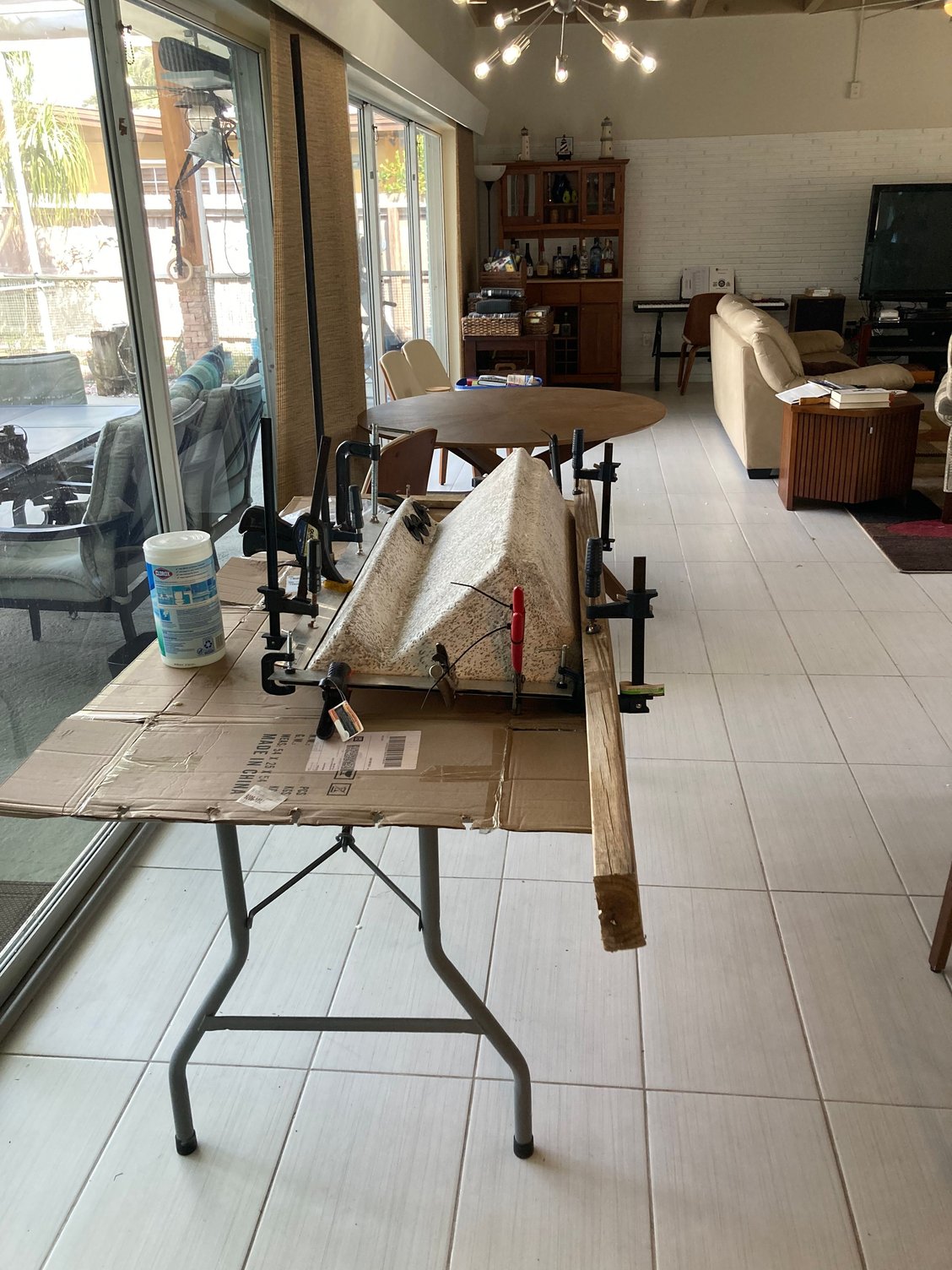

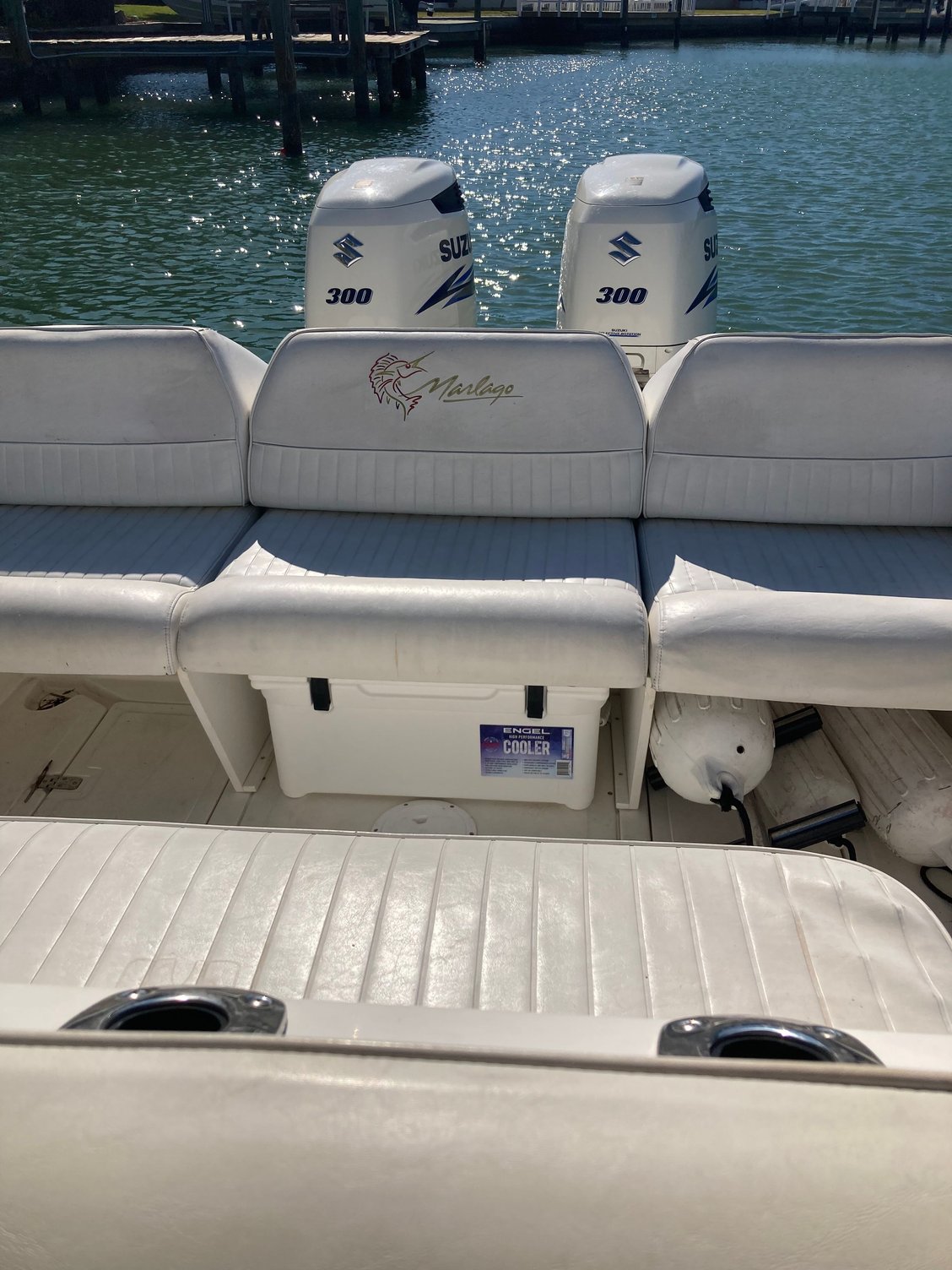

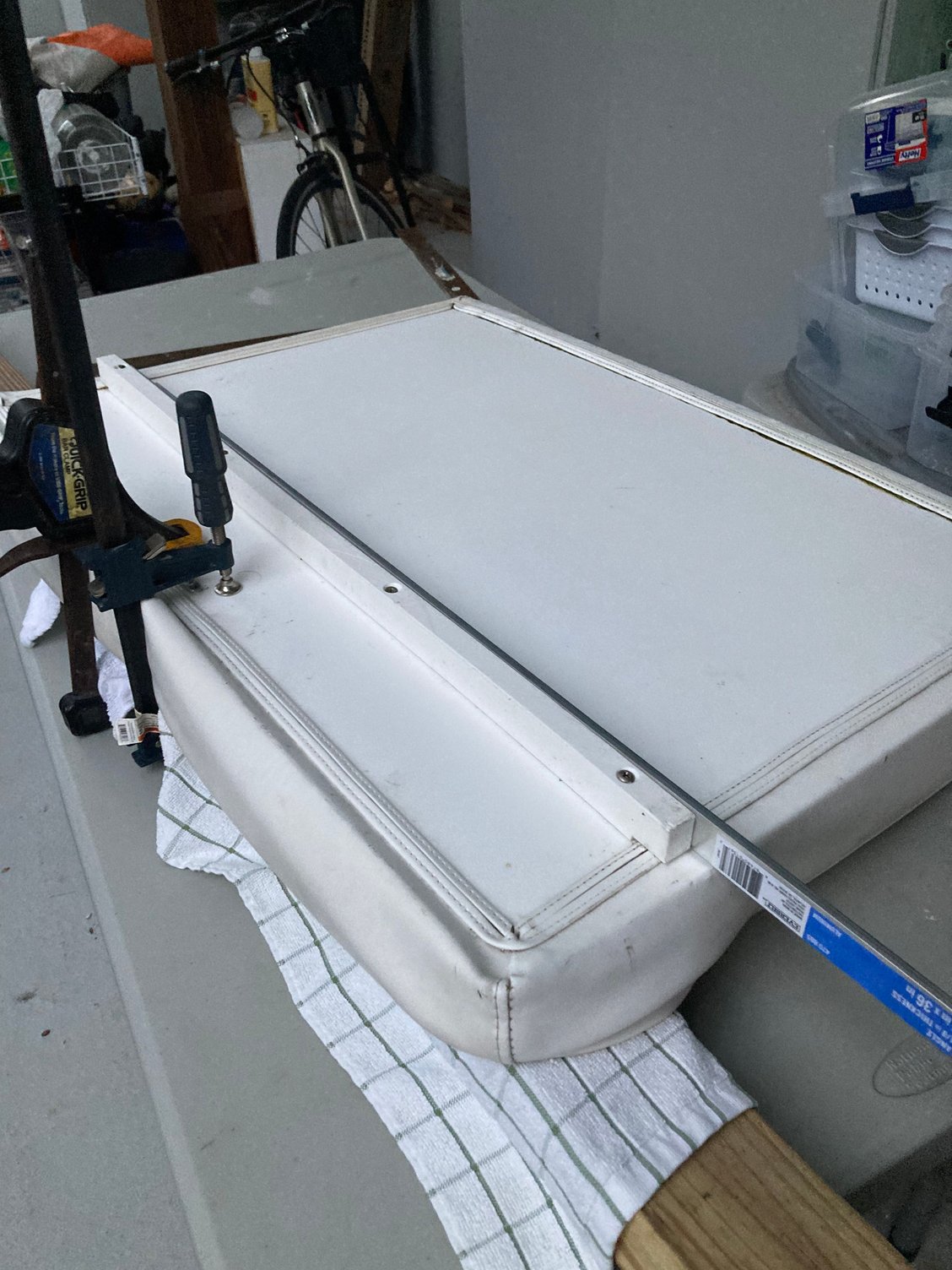

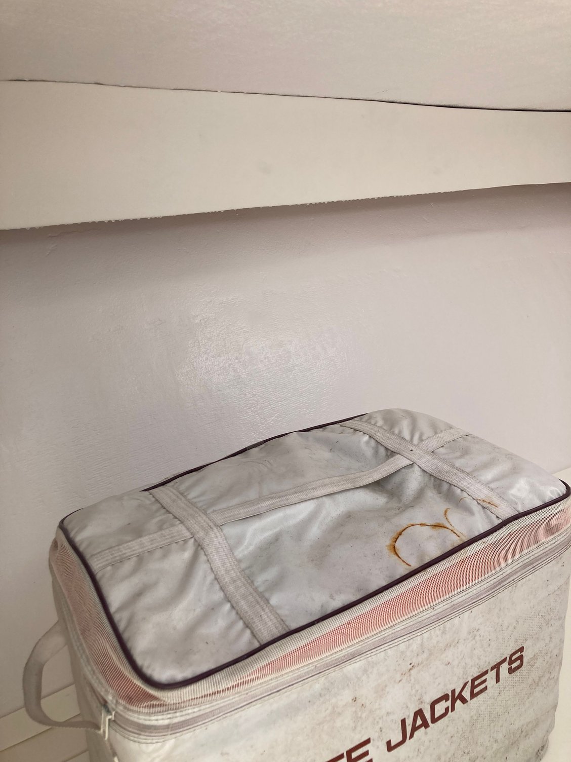

This center section of the back seat spans about 2 feet and originally had a rib of marine plastic lumber. Plastic is not good in tension so it really isn’t suitable as the section of a beam. I flattened it on a board then added some aluminum angle section to hold it flat.

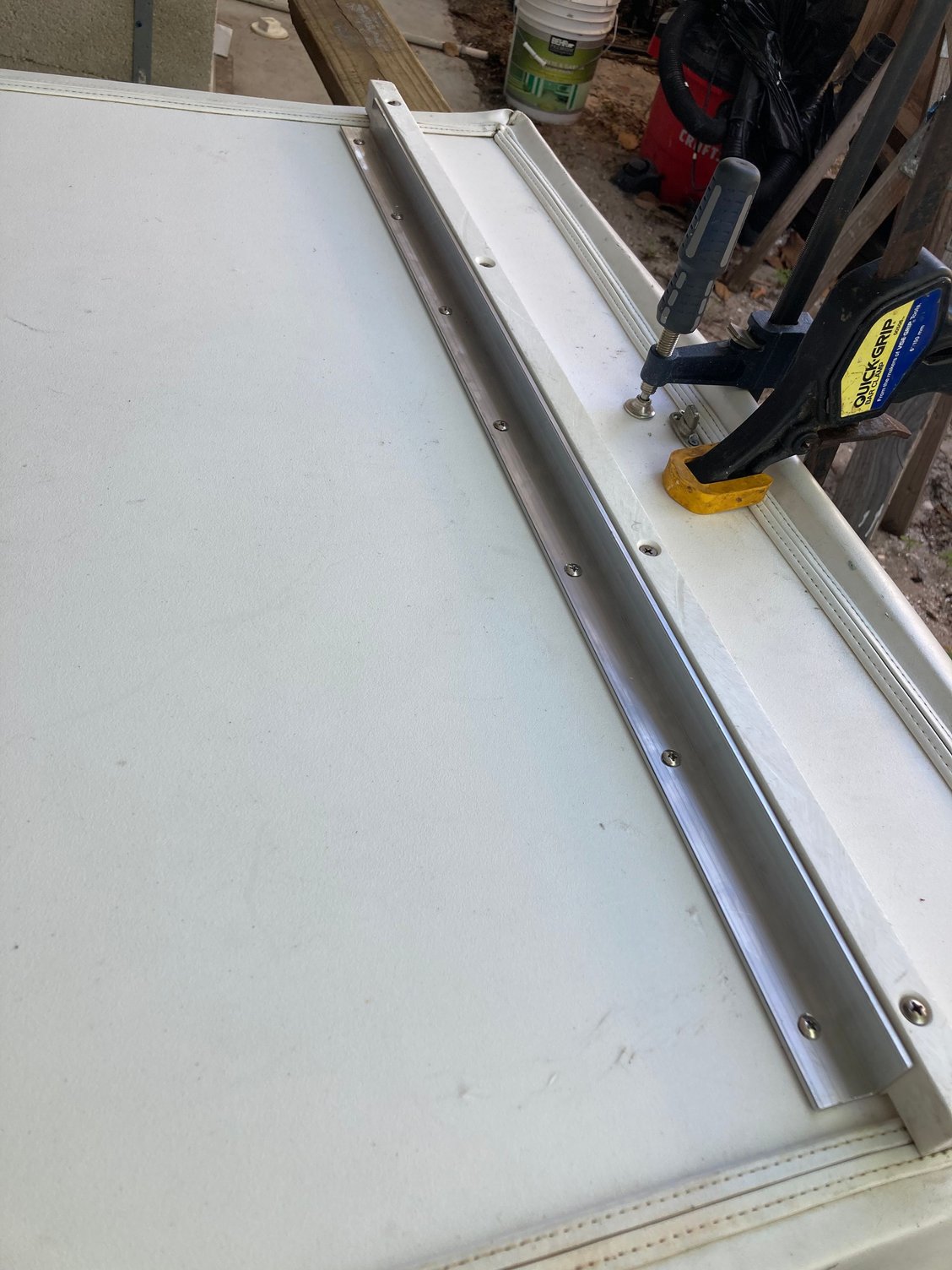

This piece spans the top of my console and covers a plexi glass slider thingy. It also sagged so I braced it with thick a SST bar. The downside to SST is that it’s harder than a whores heart, so I had machinist drill and countersink the holes. I wanted to be able to stand on this piece.

Finally found a rotomolded cooler that fits under here! It’s a discontinued Engel. The braced seat helps this too. Also replaced more sun faded hull access plates.

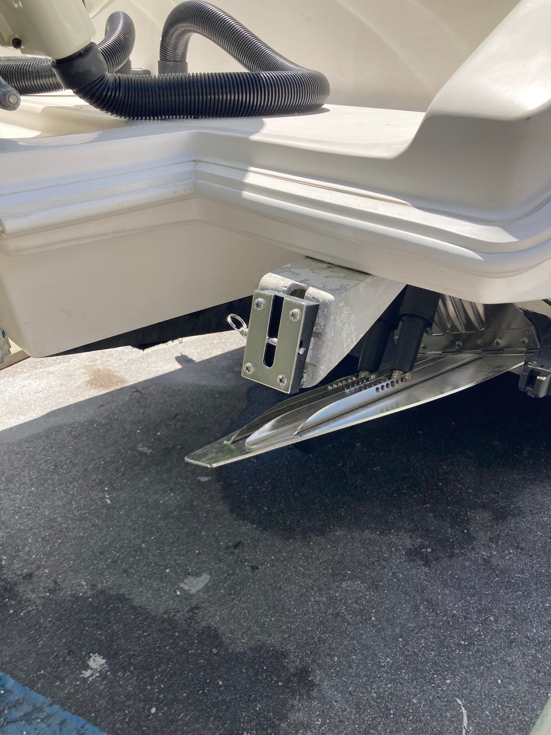

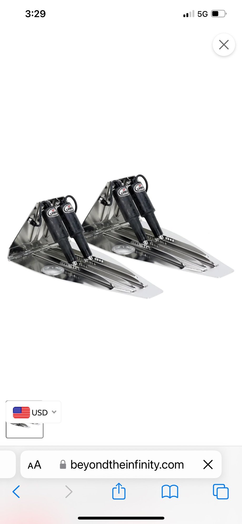

Race boat parts! 24” electric lencos with trim indicators!
This boat originally had lame little cruiser Bennett’s. At inception these were reasonably priced 50mph big for the time center consoles pushed by 2x 225hp 2 stroke mercs. The two strokes were about 100lbs per side lighter than 4 strokes. The boat also has major engine setback designed into the integrated motor bracket.
All that adds up to this boat running pretty bow light. Keeping my water tank full and my reserve tank fairly full really flattened it out. But knowing how pad boats like weight in back, this really bothered me. Plus lugging around weight unnecessarily greatly bothers the engineer in me.
So these give me the option of running the boat light and turning the props if I want as well.

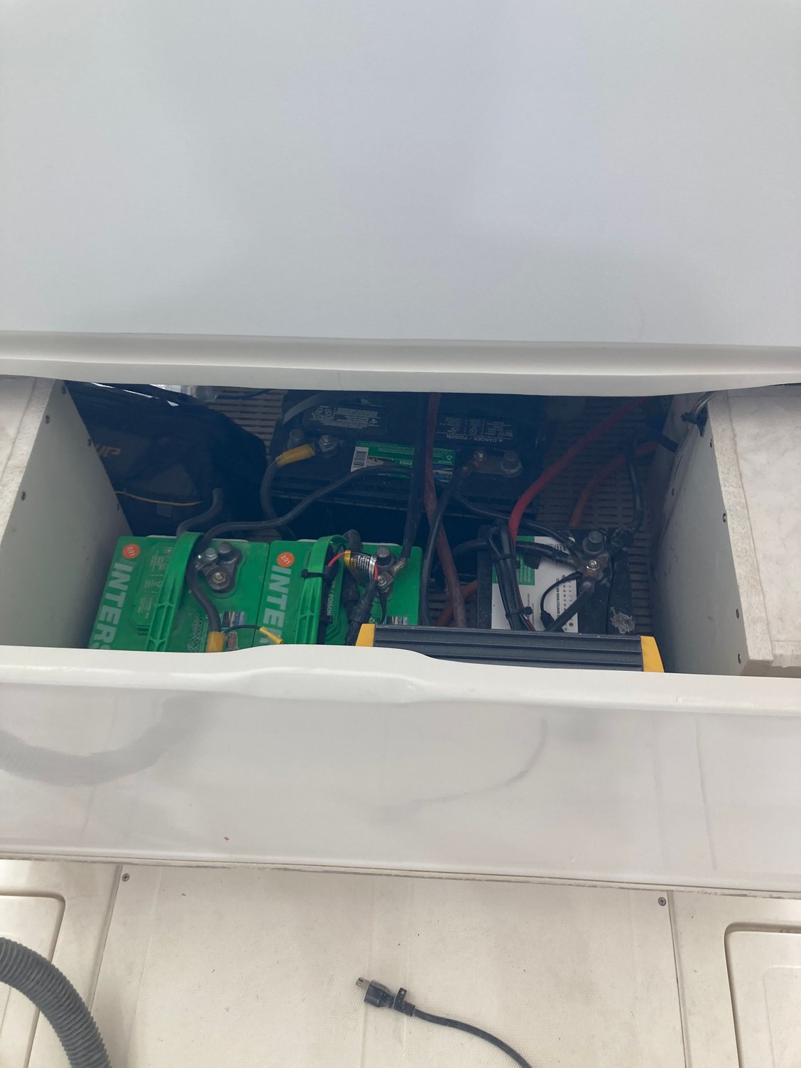

Previous owner brought the batteries into the console to shift some weight forward and get them out of the gross mildewy transom.
As my stereo boxes closed in half of this, and the watts went up. I kept adding batteries. I ended up with 3 group 31 deep cycles on a bank as a house, and 1 cranking by itself.
Havent managed to deep cycle the house bank with 2000 watts rms. Both amp are class D digital switching amps as well, which draw 60-70% of an equivalent class AB amp.
Anyways, they turned my cutting board into a cabinet door to access this whole mess. New bigger battery charger. All new cables to the motors. New posts in the transom.

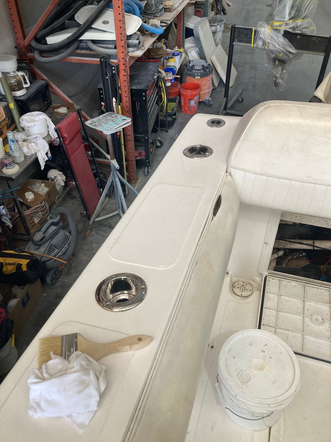

This boat always had a major lack of cup holders for being sort of hybrid cruiser/fisher. So I had the regular rod holder replaced with cup holder versions.

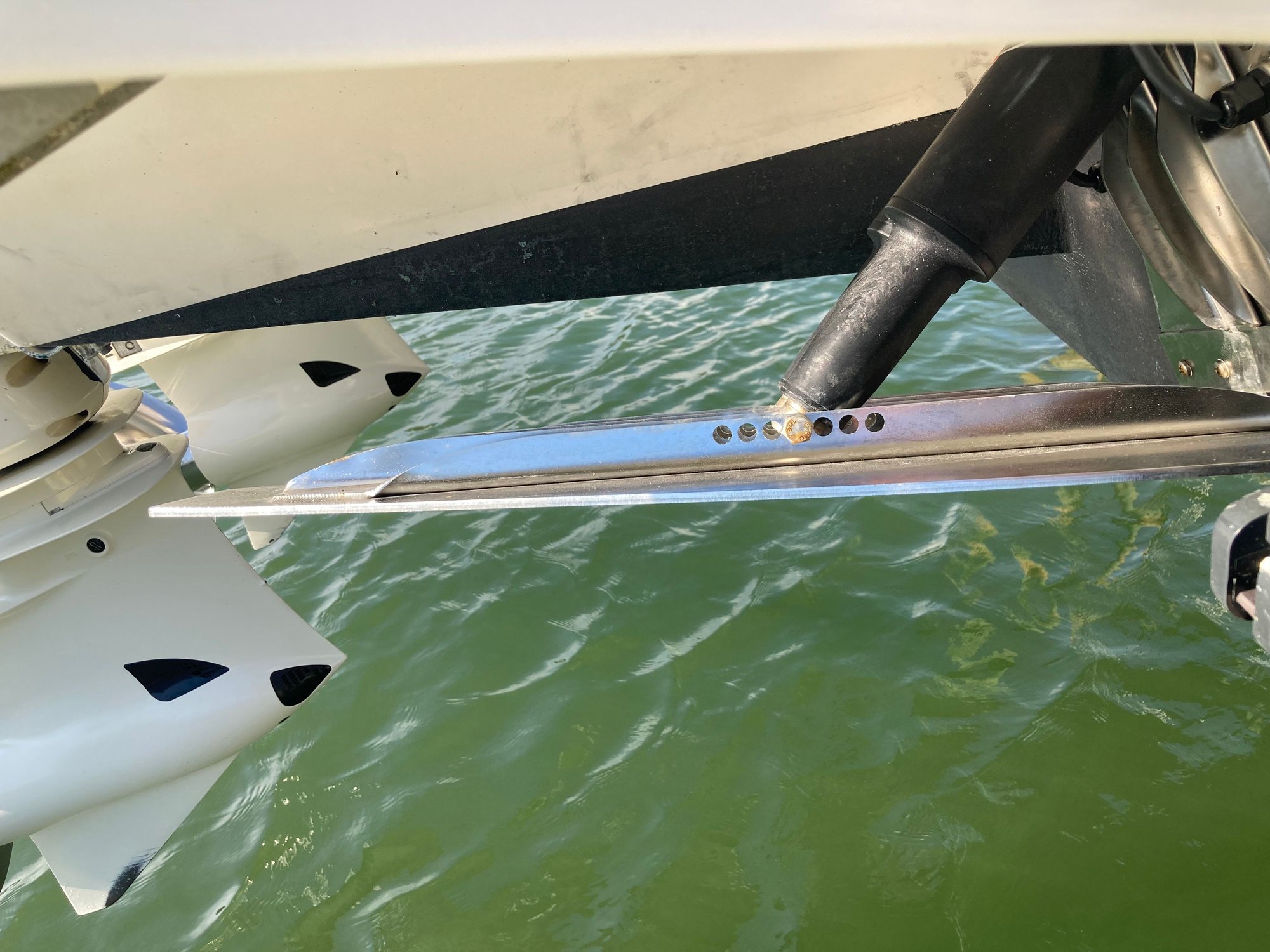

Original install. Tabs didn’t do anything in the first half of travel and didn’t stuff the bow hard enough. Brought the rams in quite a bit after this.

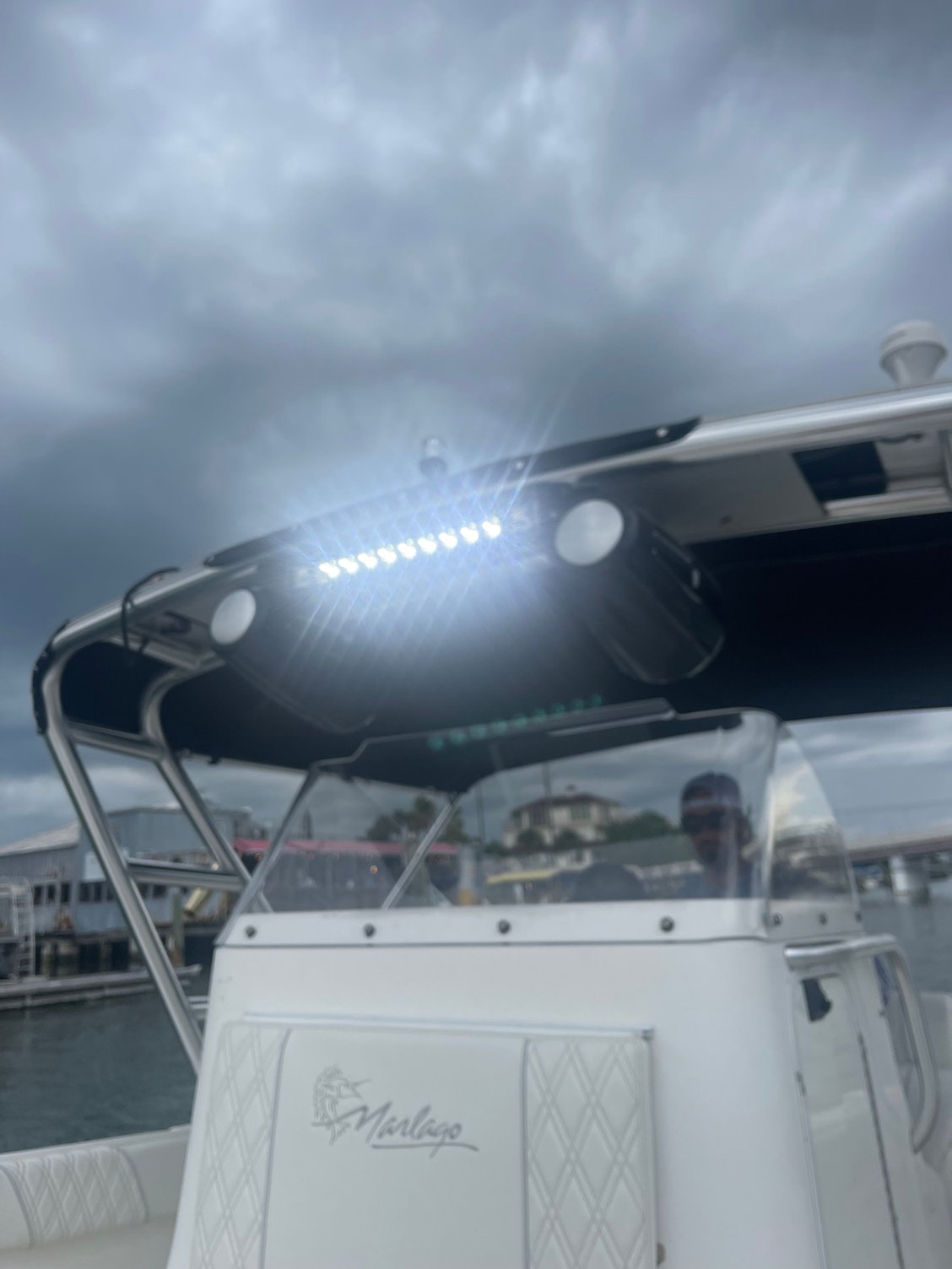

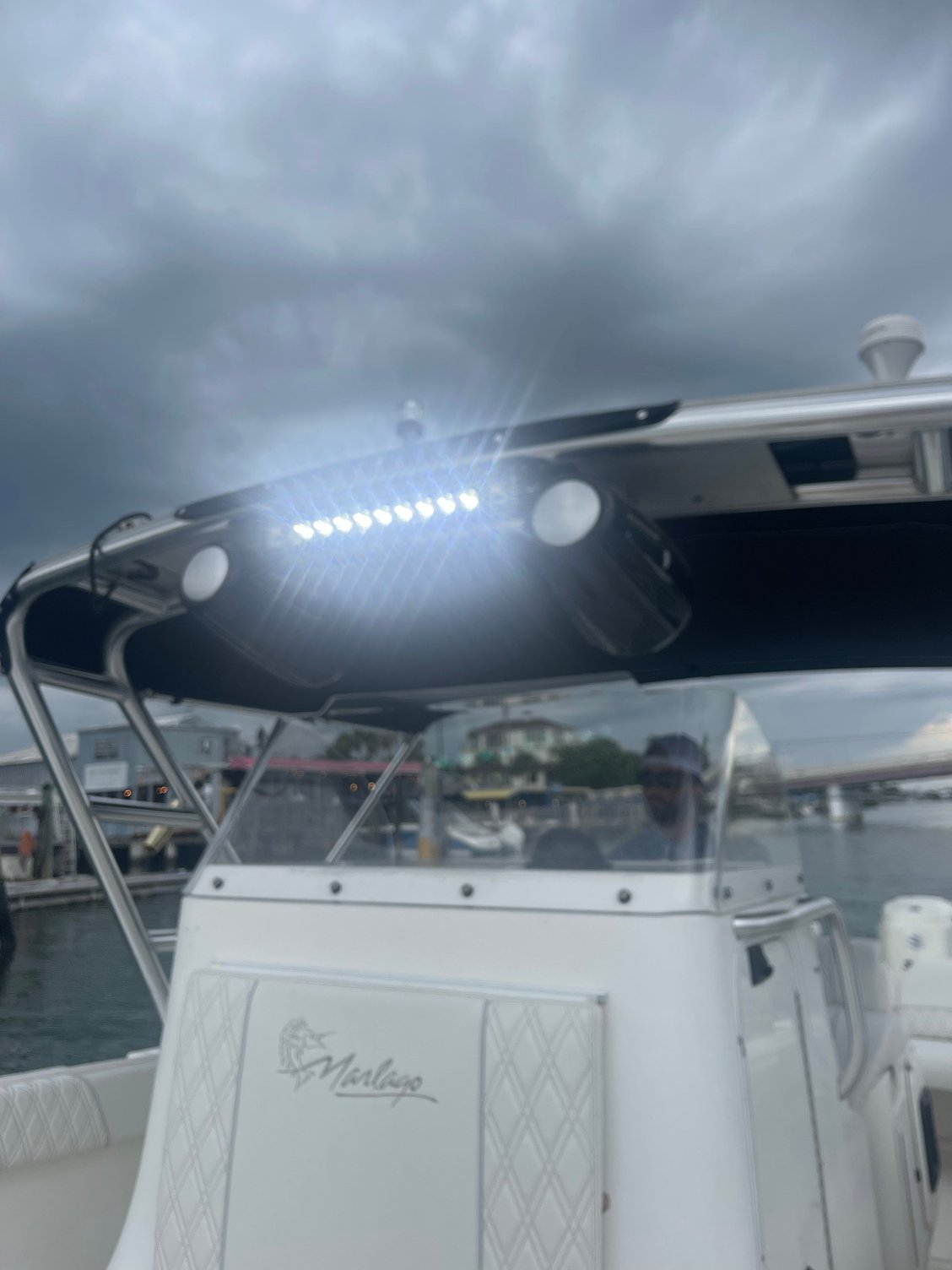

Rigid light bar. I don’t plan on being the guy ramming tour boats or channel markers.

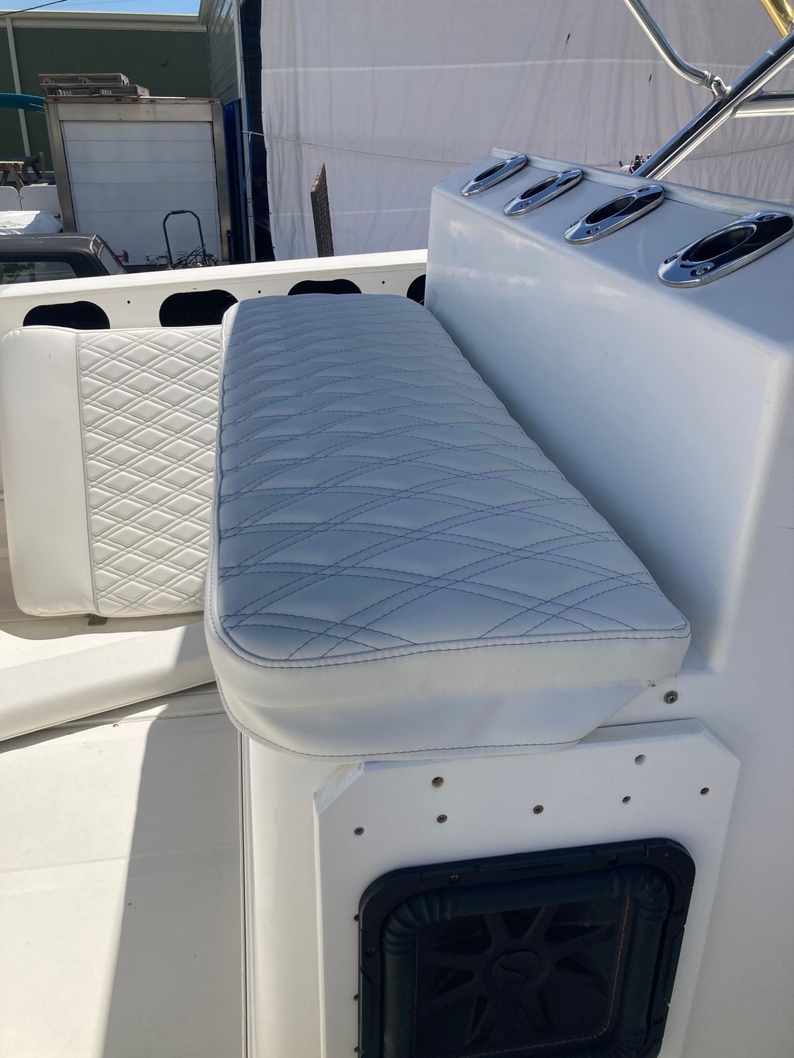

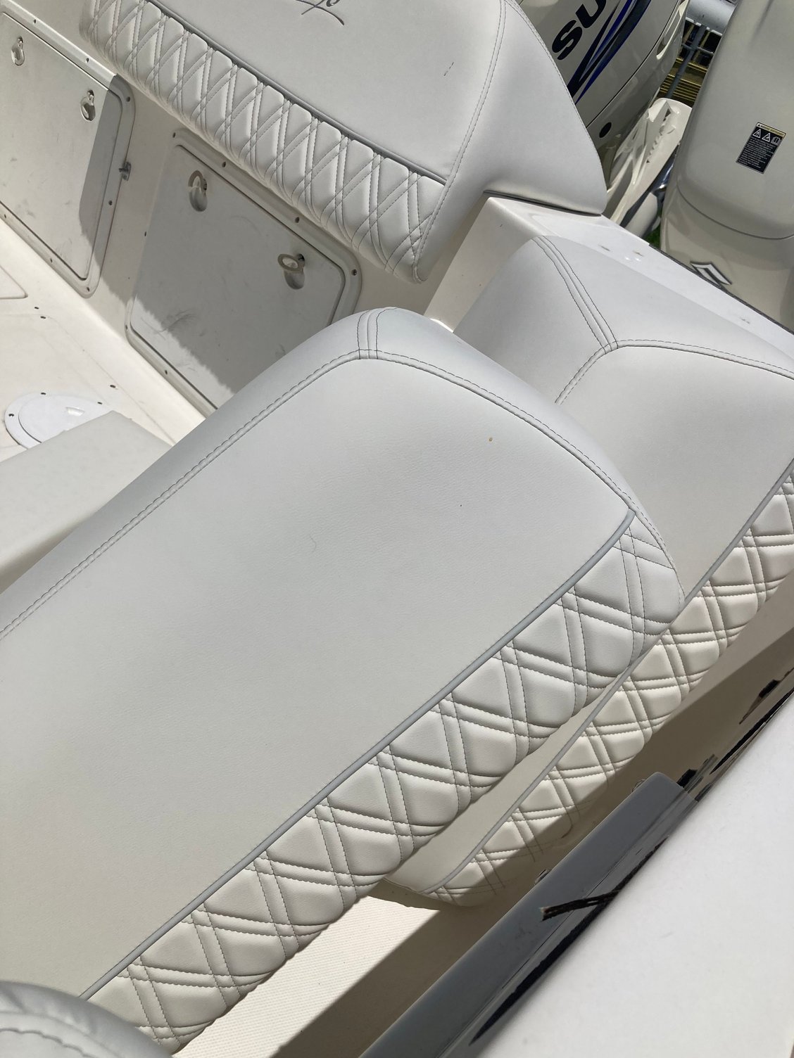

New interior! Diamond stitched with light grey threads. Newer material type that holds up better. They replicated the marlago stitching! Foam is also a higher quality. I squared the combing pads (the side pads). To give me a bit more hip room around the console.
This is a 9’2” beam boat popped from the 36’ cig widebody. A bit narrower than the typical 10ft beam modern CCs (this is a year 2000 designed in 1994)

Can see where the tab is positioned now.

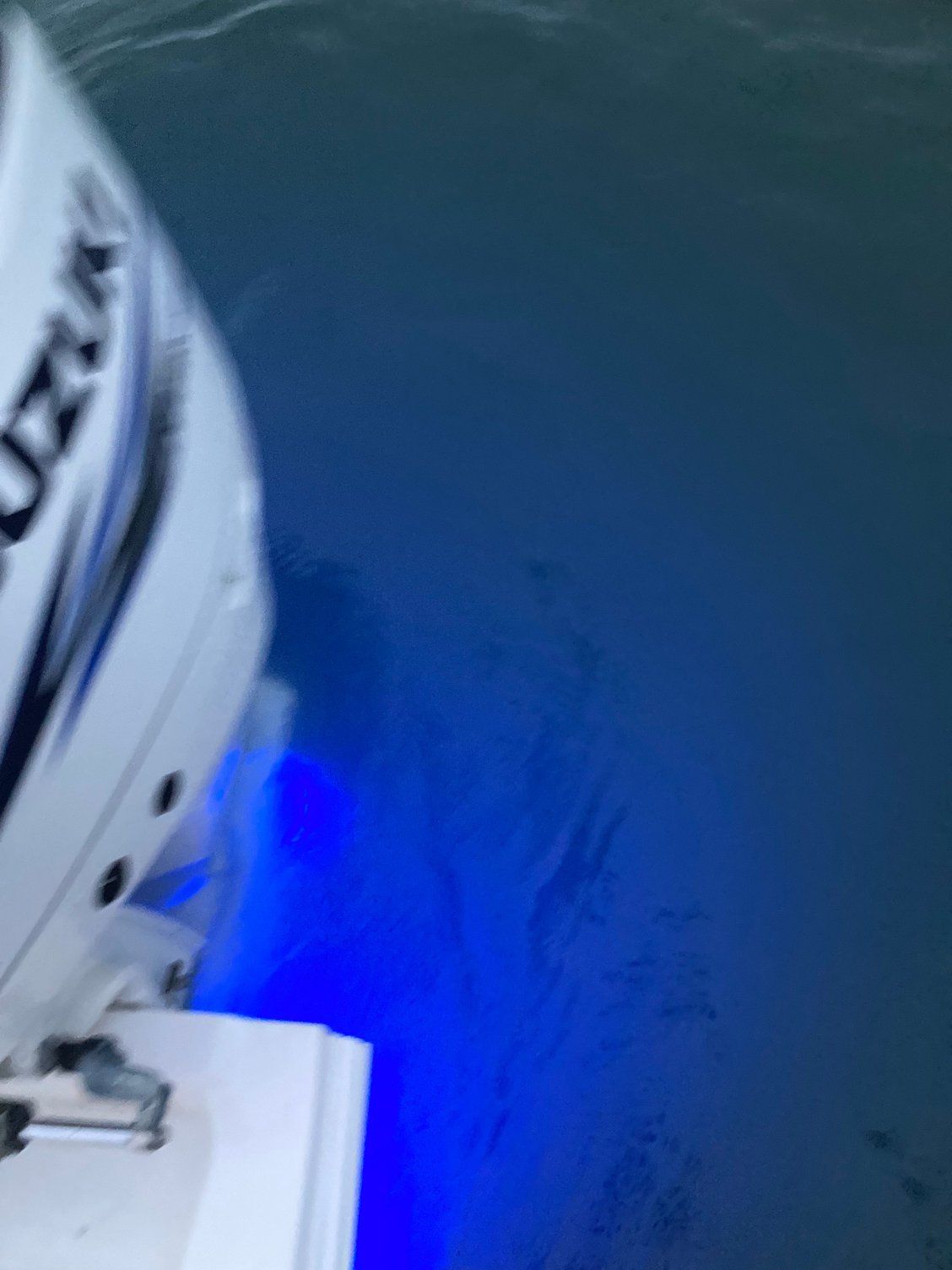

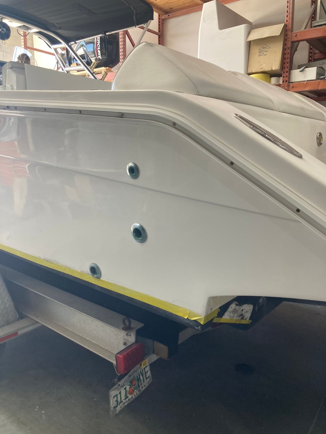

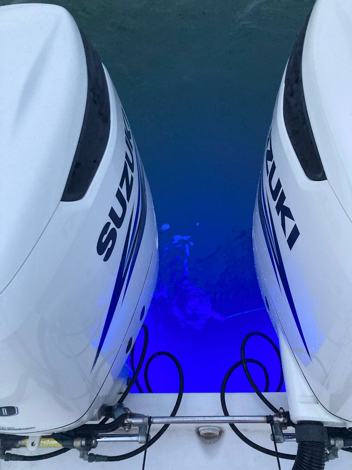

Under water lights! Don’t love the position but it’s where they could get to the back side.
You can get an idea of how far my engines are set back from the end of the pad in this pic.
Bottom paint touched up. I don’t love this. But I suppose if the next owner is a northeasterner they will appreciate it. $7k to remove at last quote, whole bottom would get re gelled.

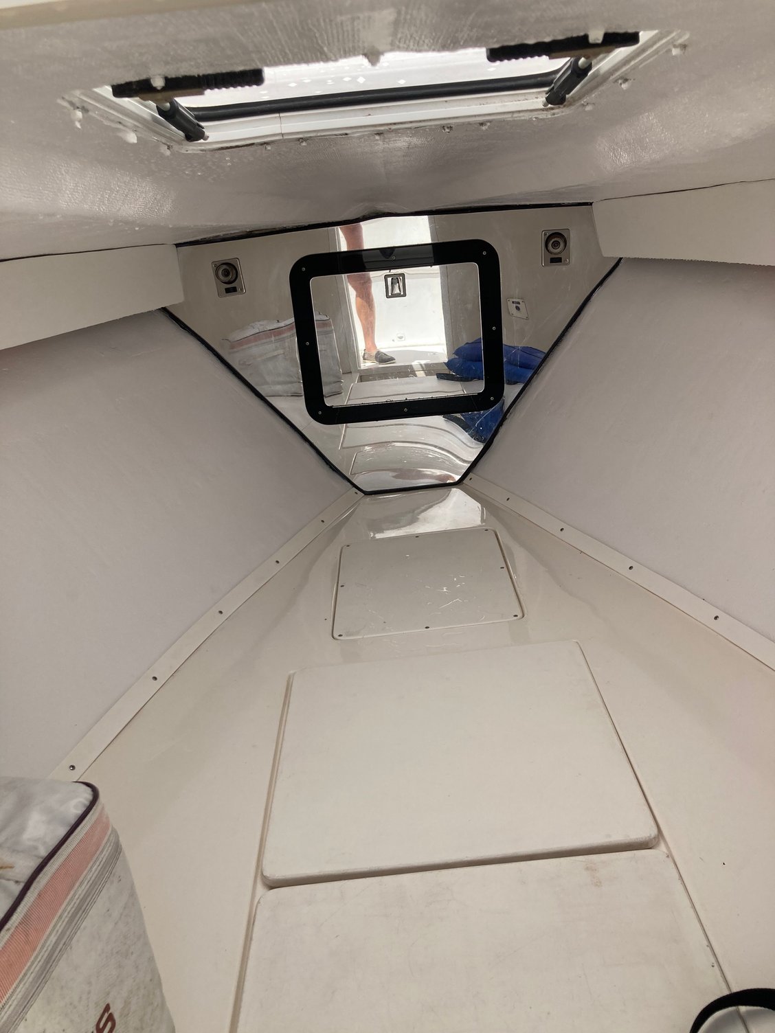

Cabin updates. Ripped down the headliner, and vinyl wall liners. Had them gel the whole thing. Now it’s hoseable. Side panels are new.
Not pictured are my also new cuddy cushions. Had them done in ultra leather like my old formula 😎.

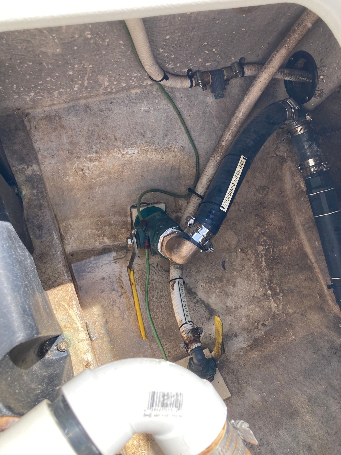

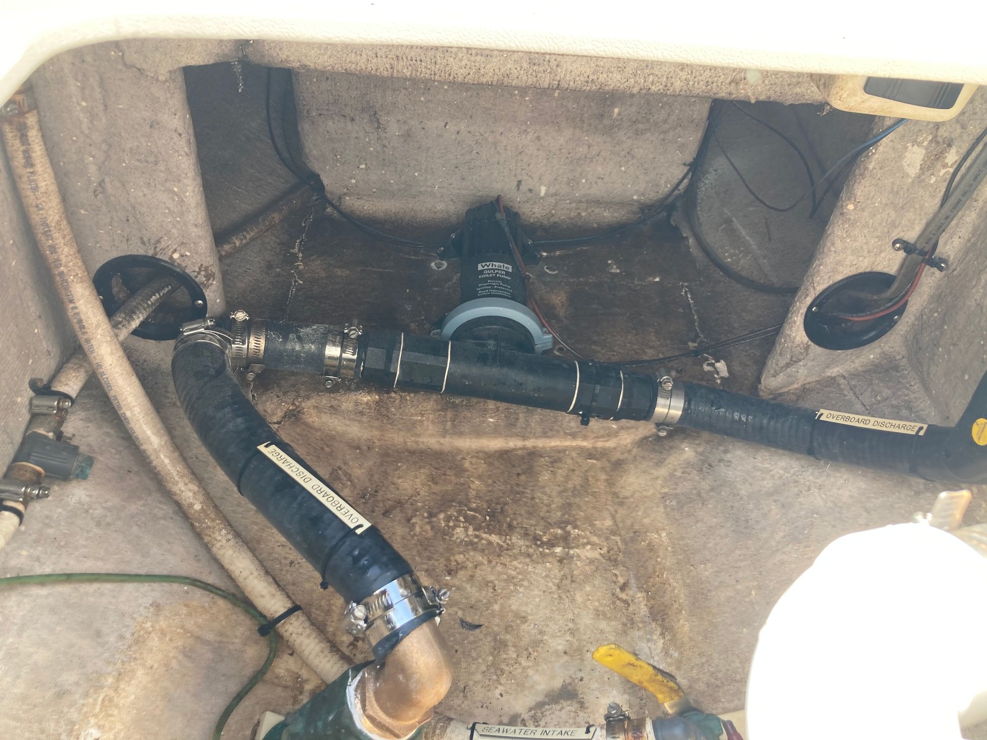

New macerator, new elbow off the discharge. Old one was a PVC elbow that broke off! What a disaster that could lead to.
Other stuff, new faucet in head, all pumps rewired. Bow light quit, ugh. Also they didn’t fix the vacuuflush. Annoying.

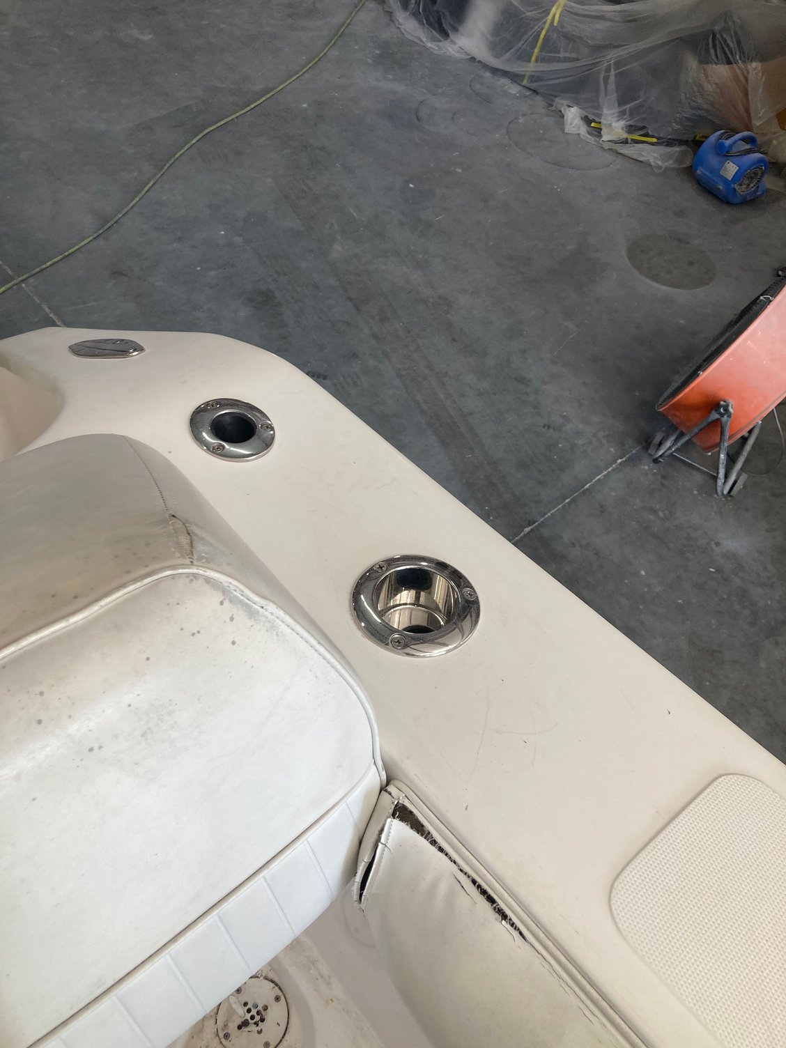

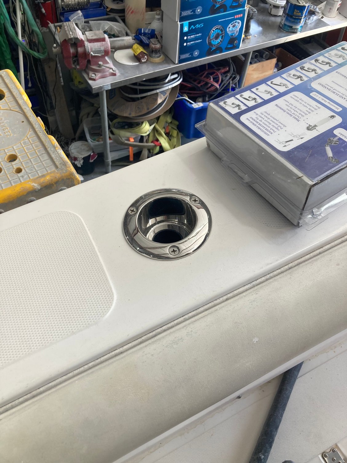

Forgot to mention I replaced the plastic cup holders with SST last year. Had to open the holes up so that cans wirh coozies fit in these bigger holders.
Of course they are cheap Chinese **** that rusts anyways. I might try to polish or one of you guys could recommend the quality brand.

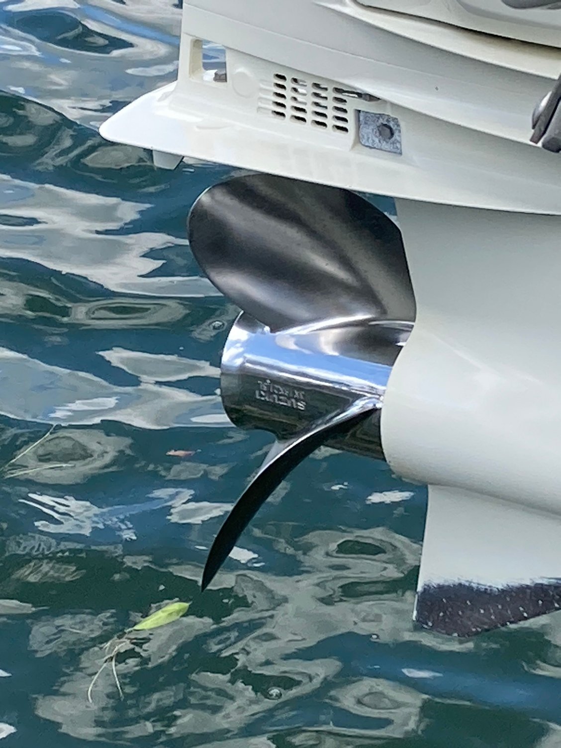

Next up is prop testing.
These are my old Suzuki 3x16x21.5 3 blades from the previous 2007 DF250s. I had cup added, which added like an inch of effective pitch. They just run great and bite like crazy but I can’t redline them. I can pull like 6000, maybe 6100 trimmed to the moon. Redline is 6300 and fuel shut may be at 6400.
Now that my water tank, holding tank and reserve tank are empty, I’ll switch them back to turning in and see if I can go over 60. Previous best was 59mph. Would be nice to be able to keep up with a poker run.
I also ordered some hubs to try my buddies 22p Bravos. I’ll have those tomorrow, and the old Suzuki prop rehubbed friday AM. Hopefully the 100hr service is complete and I can do some prop testing soon.
To get any more out of this boat would require another repower, Merc V8s would be nice. 400 verados would really move out, maybe 70-75. But for anyone with normal amounts of testosterone, this boat is plenty fast. It’s really a nice efficient package. I can regularly get 2mpg at light loads. I could not reasonably expect to the money back from a repower.
