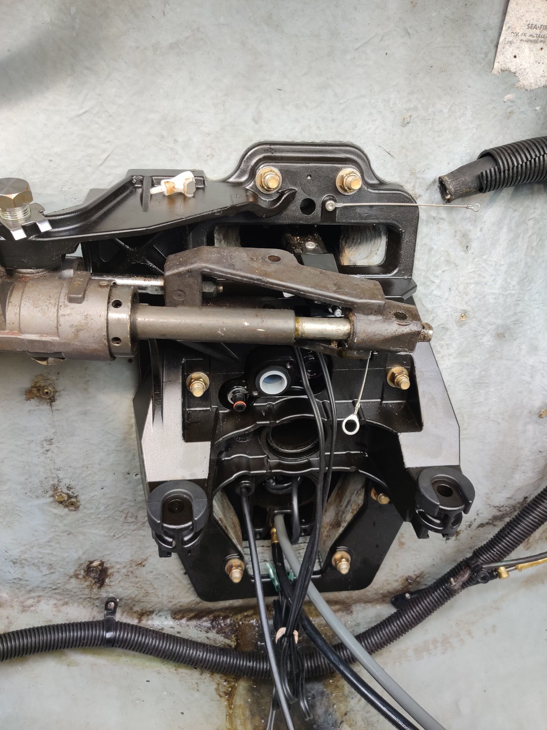

I'll probably go with the Life-Calk only because I did put grease on the seal initially. I'll clean it with a little Dawn first.

Looks good man!!! Was gonna suggest some penetrating epoxy on the cut out...but too late!!! Throw the engine in and outdrive on and go boating!!!!

Thanks. Not too late yet though. I'm pulling it back out to put the sealer on. Haven't done it yet. Five minutes worth of work to pull it. I might pick up some paint too. We'll see. The paint is in pretty good condition still.
It'll be a little bit before I put the motor in. I dropped the block off at the machine shop to have a couple things done.

While its out sand some of the bottom paint away. Bottom paint should not contact the transom assembly, and most leave 1 inch space.

I think you'll be pleased in the long run .
One of the nice things about the lifecaulk is that it's very easy to trim away the excess . I often use a wooden chopstick (like the ones that takeout Chinese food come with) and sharpen the tip up a bit .
