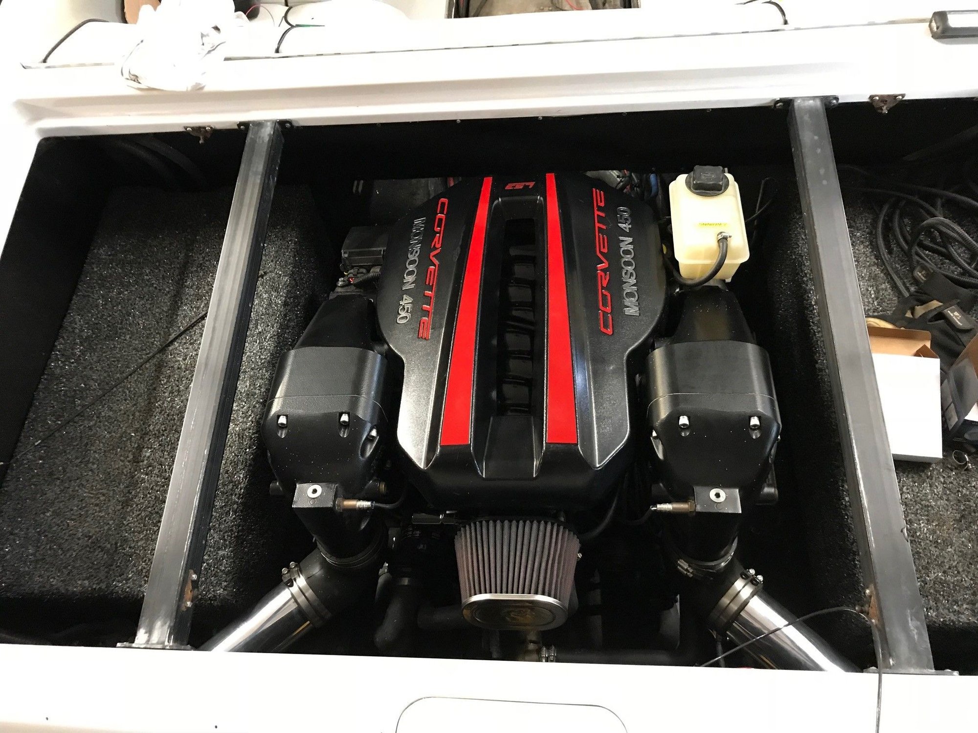

That said, I recently took part in the installation of a 450HP Marine Power LS3 into an older Ski Centurion and it went fairly easily, aside from missing the fuel pressure sender and having to call MP to figure that out. I bought the engine originally thinking I would offer an accessory kit for the guys wanting to provide their own LS but never got around to it and sold the engine to a buddy.
so did you complete the installation in the ski boat? How has the engine held up?
Yes. Engine is installed and running. Prop is too small at the moment so it will bang the limiter pretty easily. I think its only had a handful of hours since install but seems to be running well. Had to use a Corvette regulator but bolt in otherwise. DTS so the electronic shifter had to be added also. Boat is a 2000, Engine is a 2014.. & no mufflers!
What DTS throttle did you have to use?
