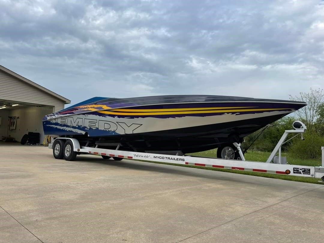

Originally Posted by Egibson
New here..just curious, is the main consensus not to paint relative to the location of “below water line”?
I have a 1990 Baja 250es. Bottom is in good shape and runs fresh water. Wanting to change the color scheme on everything above water level. Is 2-stage auto paint reasonable in this application?
There is no reason you can't paint below the water line. The bottom of our AT is single stage Imron gloss black paint and we have had no issues at all, also no loss in speed with the single stage Imron paint. We do not leave our boat in the water regularly and only for no more than 2 or 3 nights if we are at a poker, as well as occasionally over night on our home lake. The hull sides up are base coat clear coat paint on ours as well.
