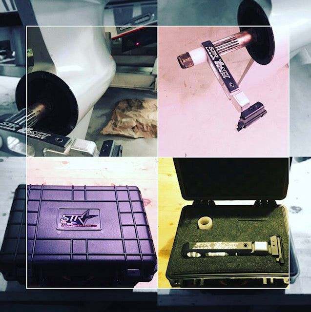

I would get in touch with Shaun Torrente for advice and for purchase of motors
Shaun Torrente Racing
Shaun Torrente Racing Established As Authorized Mercury Racing Dealer
STR X-Act Laser height kit
https://shauntorrenteracing.com/coll...t-kit-sm-bravo
