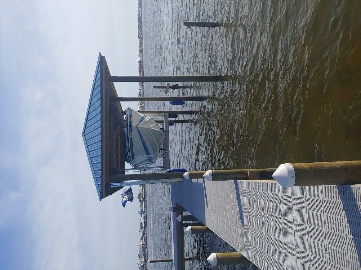

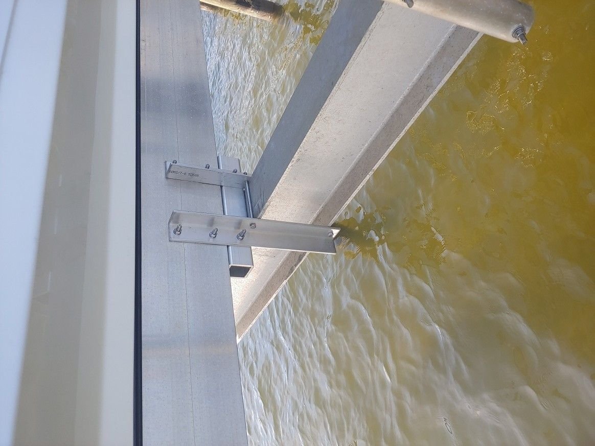

Thanks for all the inputs/support. My bunks already have a rubber pad attached to the aluminum top piece which is fabricated at an angle to match the boat hull "V". Boat traffic (wakes and winds and currents) can make docking/lifting temporarily challenging...therefore, my overall goal was to have more margin of safety/error so that I do not impact the lifting strakes or the chines.
By installing four 2.5" spacers I was able to spread my bunks a few more inches (giving me ample clearance from the hull features) while keeping the keel clear of the cross beams.

Went down this road twice with Richey Sutphen, RIP, and boat lift companies back in the day. Sutphens had a full length stringer system. Richey specifically used to say to support boat placing bunks directly below stringers. Most boat lift companies didn't really care where they placed them. So I would have them call the manufacturer and verify the logic to my request. Typically the hull would have to be centered on lift with vertical uprites.
