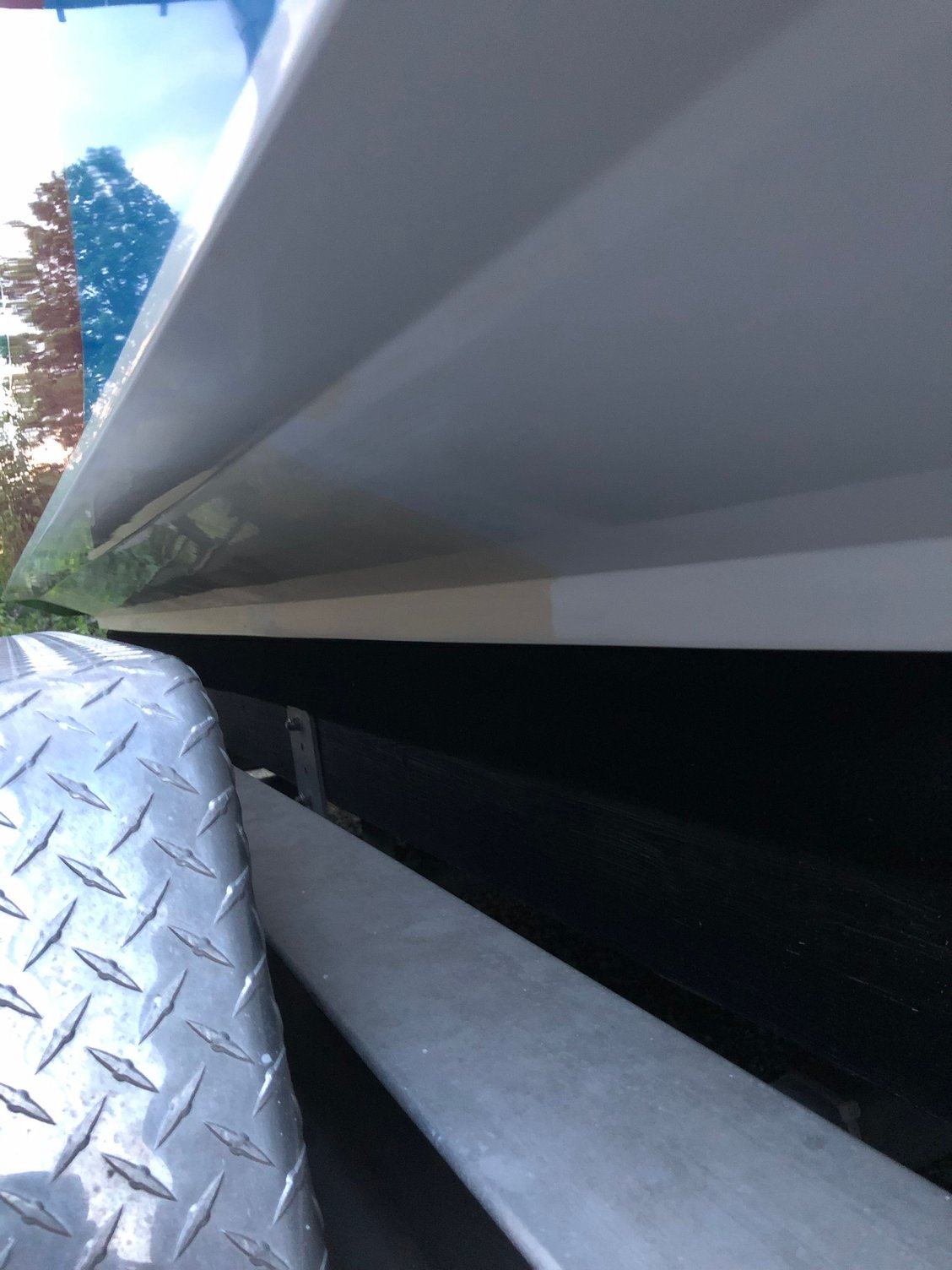

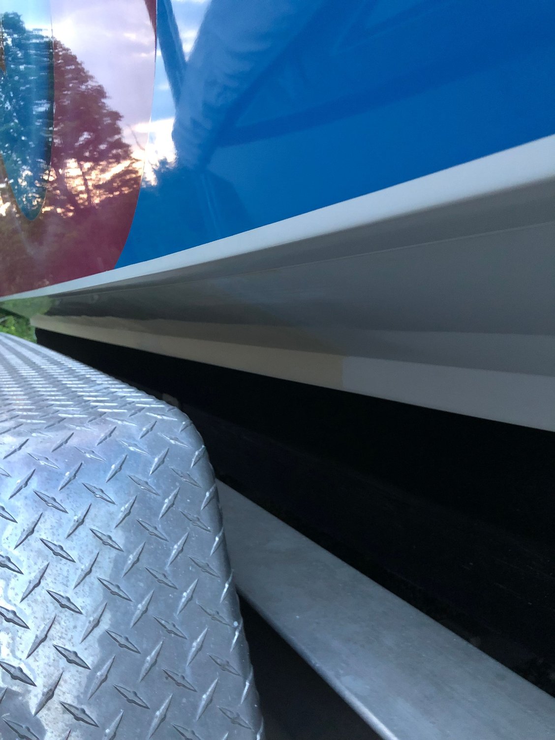

do ceramics prevent brown staining. For us the answer is yes. We have been out with the boat 5 times (fresh and salt)…running time around 6-7 hours. Boat was in the water for 20-30 hours. and it’s very visible where the ceramic is protecting the gel. We purposely left the rear chines untreated because we wanted to see the difference in protection. As you can see it’s quite obvious where the ceramic starts and ends.

The other test we did was apply the cheap griots ceramic wax on a small portion of the rear chine to see how it would hold up on the bottom. It’s holding up surprising well with just one coat. Again. You can see the difference in color.

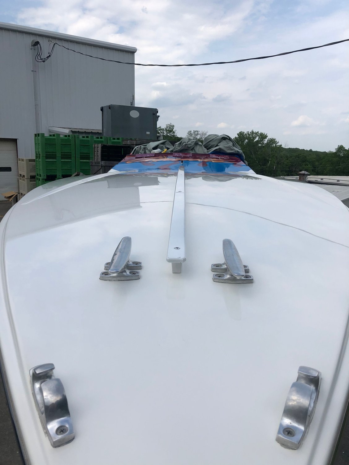

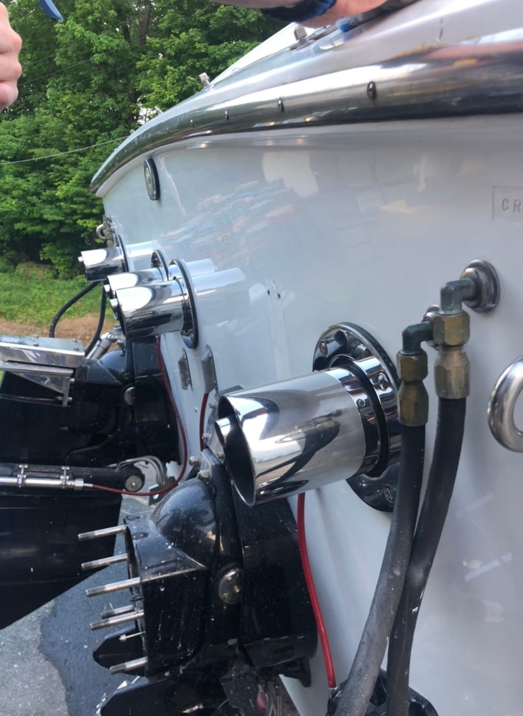

here is another picture of how the car pro quartz finished on the transom

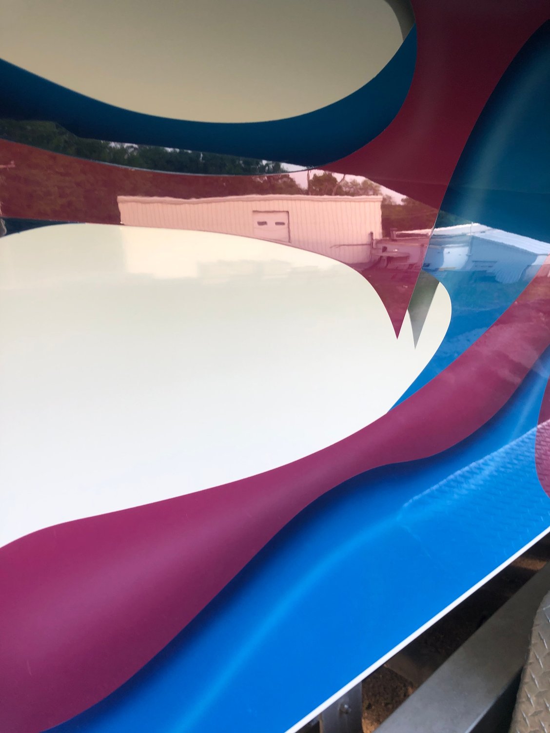

Here is how the griots finished on the sides and top.
