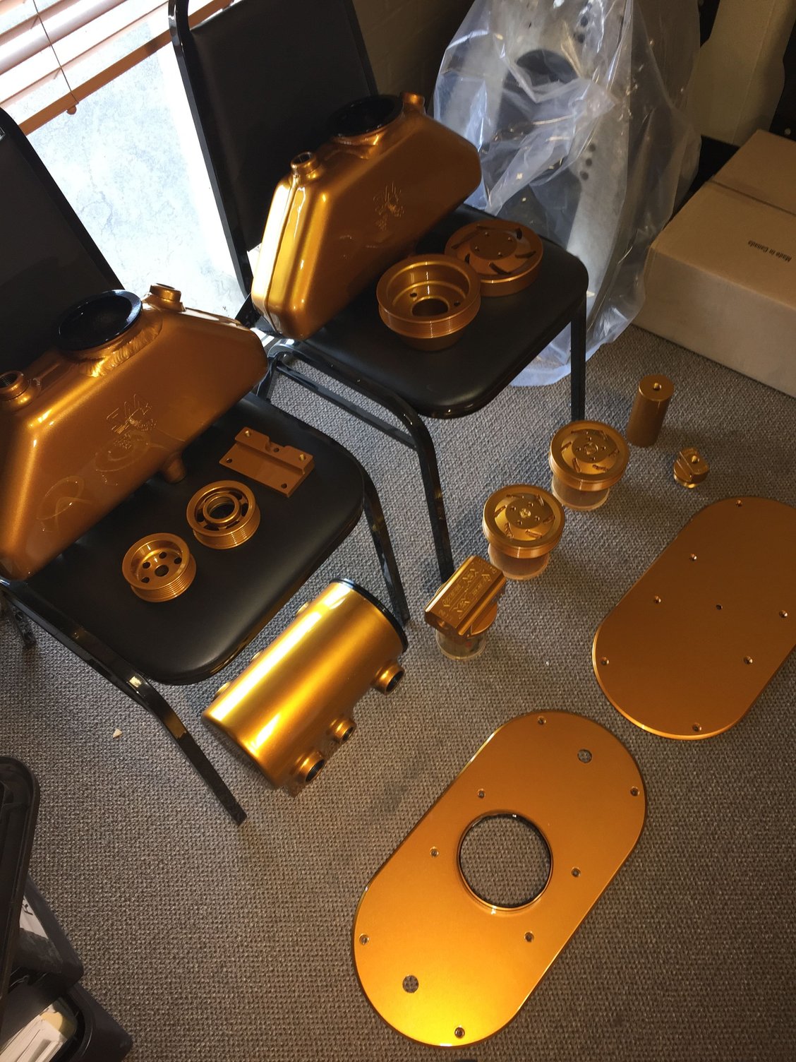

As you can see in the last picture the candy really pops with light. All these parts are boxed and ready to go.

Did that on the engine accessories. All was new and was not really happy with the outcome. I wound up painting everything a candy gold.

Was really for corrosion factor, since it is all disassembled and in good shape.. The tabs are powder coat and finish is dull . Figure I can get everything cleaned at once and what would be the best route to go. Looking for input cause sometimes I tend to over think some process.
The 3 Teauge pump tanks are 2 piece and the anodize didn't hinder the bolts going in , but that was just gold anodize and not HC. When I painted them I had assembled and just taped the allen bolts.
The flame arrestor,battery trays I just stripped and painted ,manifolds are new /painted as well as sea strainer.
