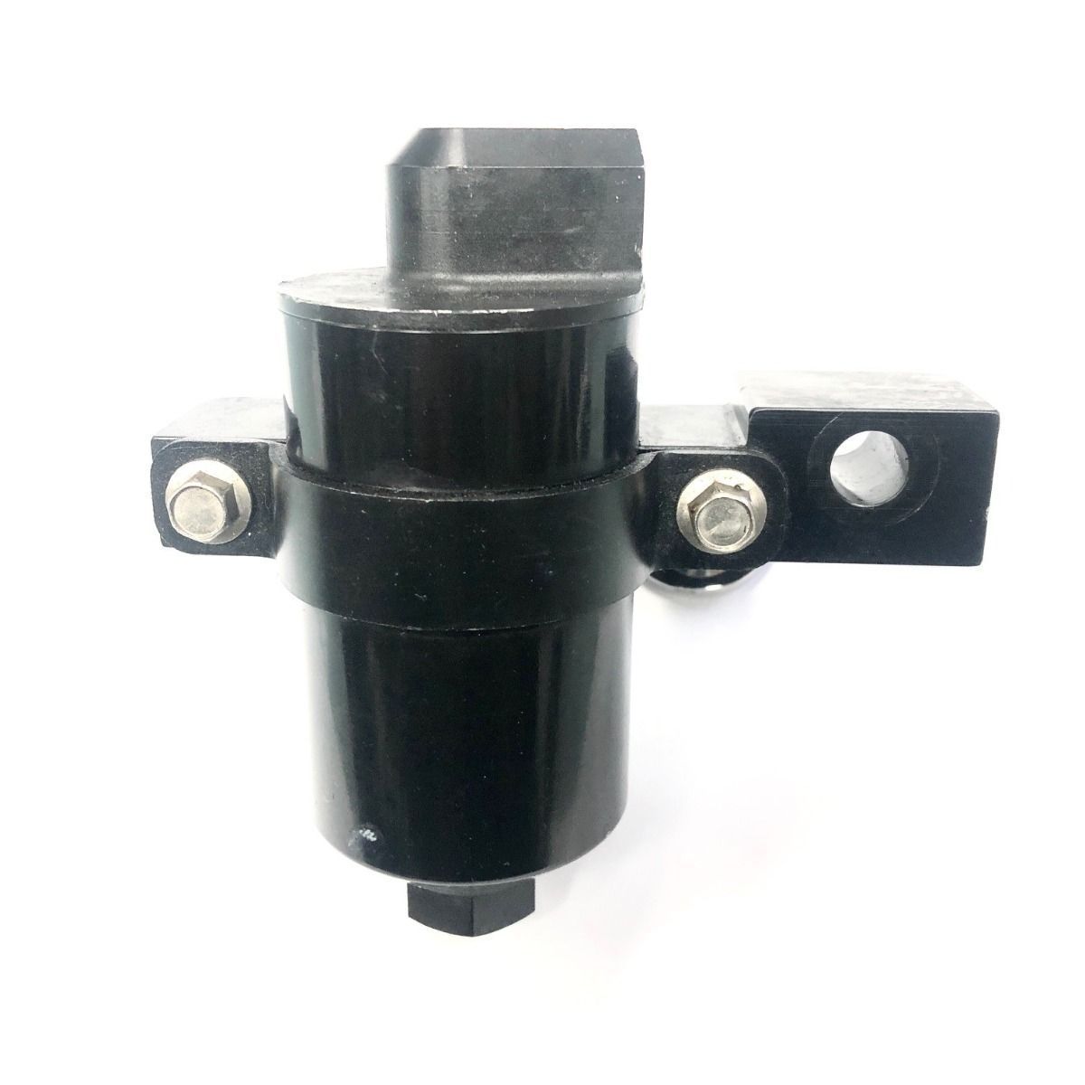

This is a nice blue anodized aluminum cannister and not cheap although Ian informed me that Teague has some used ones available. It's not chewed up either. Just minor damaged that isn't too bad.

Like this but blue. $256 list for a new one.
