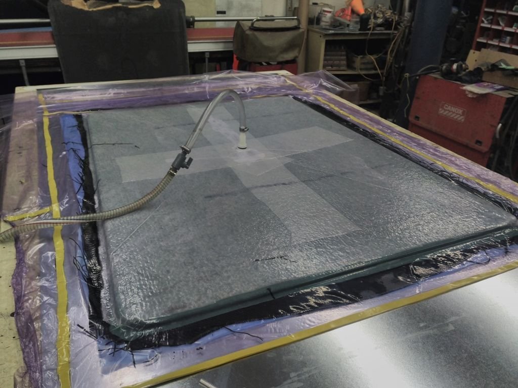

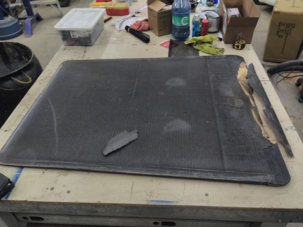

So I had a ton of fun in the Thundercat last summer. I broke the floor in multiple spots at the end of the season, so I knew I had some repair work to do. When I pulled the floor panels out I was surprised at how much damage they had taken. Not really repairable, so I made a new floor section. The original floor was 1/2" foam with two layers of carbon on each side. With the amount of failure it sustained I figured I better make the new one much stronger. The new one is 1/2" foam core with three layers plus a Kevlar layer on each side plus three layers at the transom. I made it yesterday, just need to clean up the edges today, let it cure a bit, then see how strong it is!
