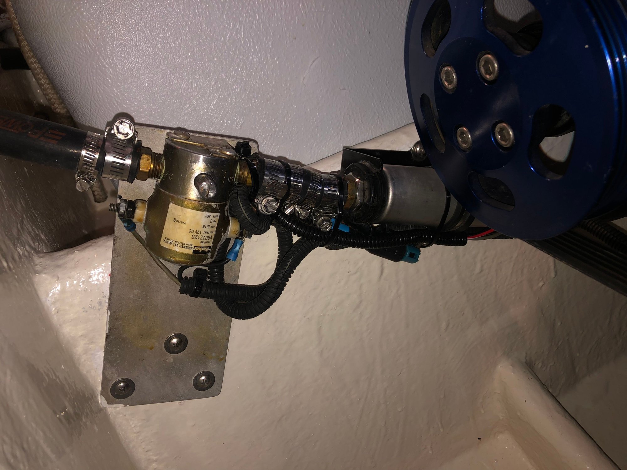

I have those kind of regulators in front of an electric pump before the separator. I also have a second electric pump underneath the front of the engine. Never had an issue. Are you set up like that too?

No mine is not set up like that

Jeff32 - that the electric antisiphon valve merc suggested as an update at one time and lots of sea rays seemingly come with ?
Isn't that just a solenoid, not a regulator?
