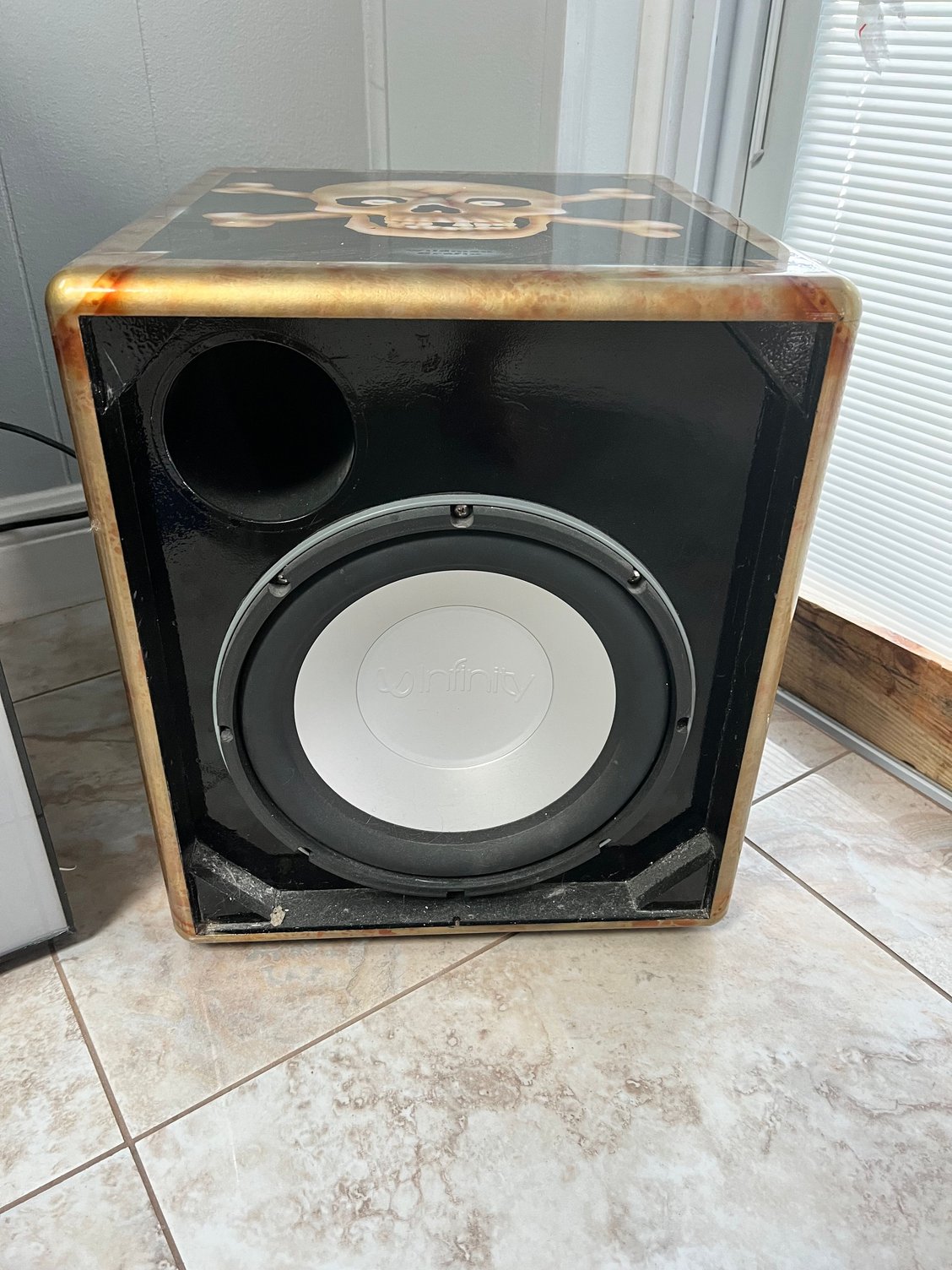

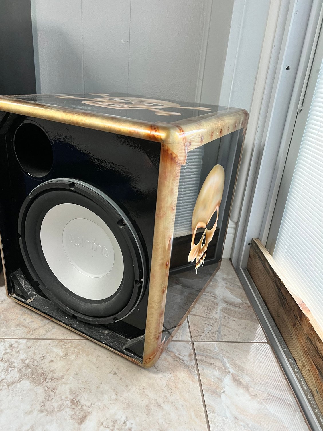

LOL Yes the perfect 10's were nice, they put out a lot with little power. Still have this one I made for my shop years ago.

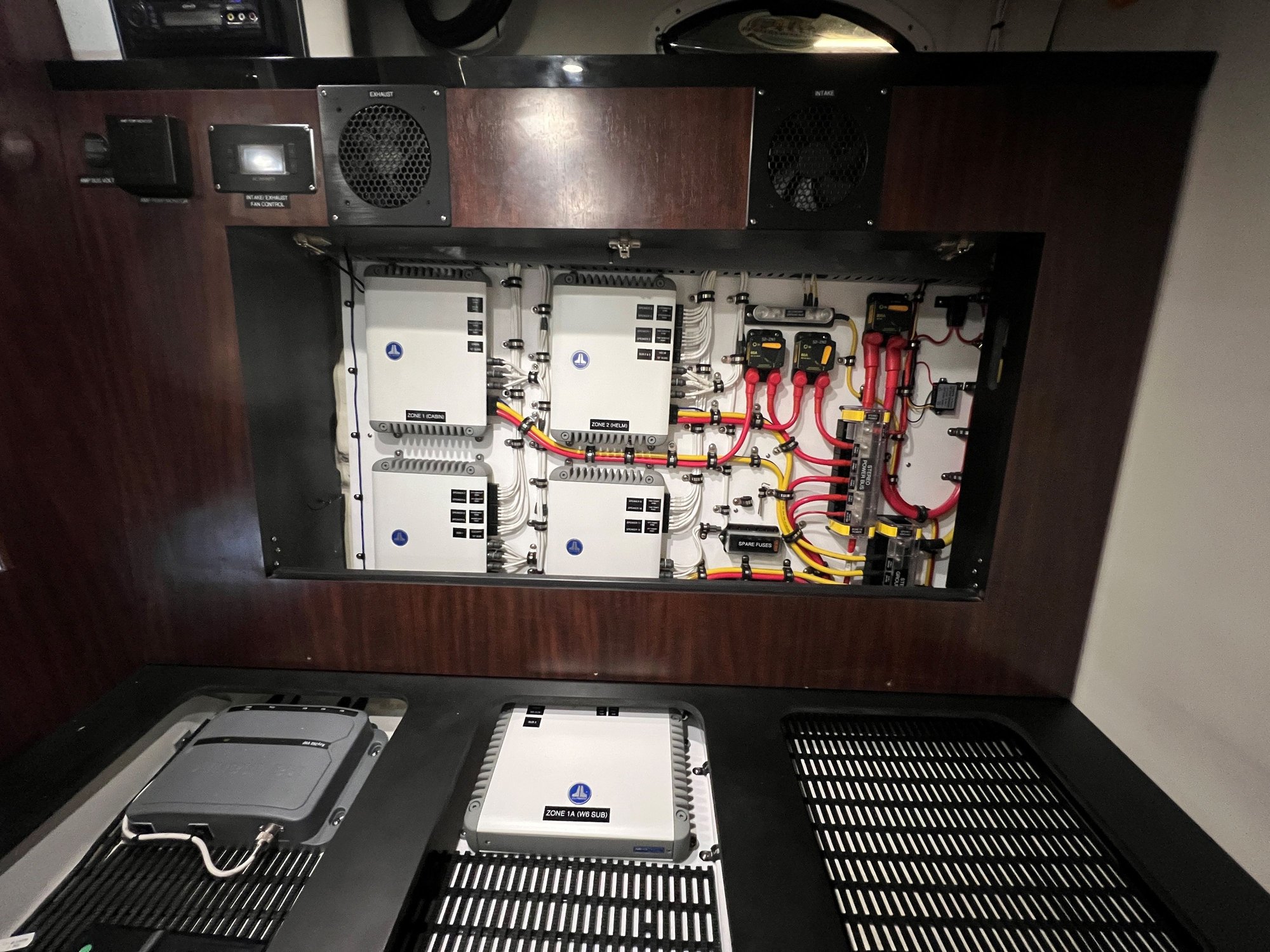

I would love to know the exact list of the equipment in this build, I cannot imagine how it is even close to $100k. In my cabin cruiser, I have all top of the line JL and have about $35k in all materials. I did the labor myself and saved around $31k with 250 hours in the build @ $125/ hour (No clue what the going hourly rate is).
Going further, 28,000 watts at 12.5 VDC equates to 2,240 amps (at full volume). The only amps that I am aware of that have full output at 12.5 - 14.4 volts are JL Audio's HD line. This 26' boat obviously doesnt have a generator so it will not be above 12.5 volts (13 volts if lithium) while off of shore power. Just for fun, I looked at Kicker's line of marine amps and the largest is a 1200/2, which would only make sense for 2 subs but whatever. Regardless, 14 amps x 1200 watts is 16,800 amps.
I would absolutely love to see what possible battery setup that could fit on a 26' boat and would allow him to run this system for 10 hours. Even if it was a lithium setup with 100ah batteries that he was draining down to 0% SOC (which is unrealistic), it would be ~22 group 31 size batteries. Now, obviously no one cranks the volume all the way up for 10 hours, but you get my point.
*Picture of my almost finished amp rack to prove my knowledge in this subject.
