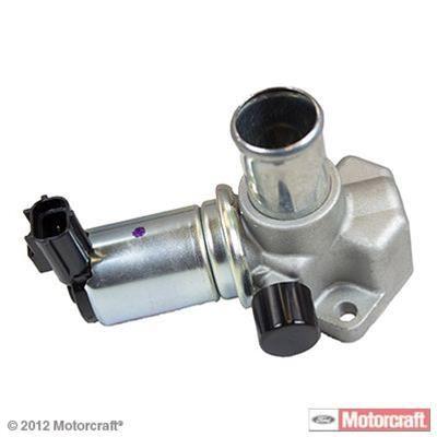

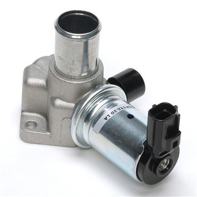

Quick searchsearch, looks just like a 2004 f-250 super duty 6.8 V-10 iac
Motorcraft Idle Air Control Valve
Part #CX1870
Delphi
CV10135
MPF 320267
Line: NAPA PROFORMER
Mercruiser 525efi 892313T02

I see that the ford part # is etched into the front of casting. So if you chemically strip merc blue paint from that spot, you should be able to see ford # and cross reference.
here is how and where they etch it

You might also try to cross the Motorcraft to the Delphi brand. I bought one for a Ford that looked just like that and was shocked that it was made in the USA. I bought it at AutoZone (IIRC) and asked for the Good/Better/Best thing and those were the best they carried. I think Delphi was a subsidiary of GM.
liquidlounge is offline
Old 08-22-2022 | 09:45 PM
SB
Joined: Nov 2004
Posts: 14,154
Likes: 3,714
From: On A Dirt Floor
Read my post with pics again. :wink The Delphi is there. And yes, my memory is same as yours Delphi was part of gm back in the day.
