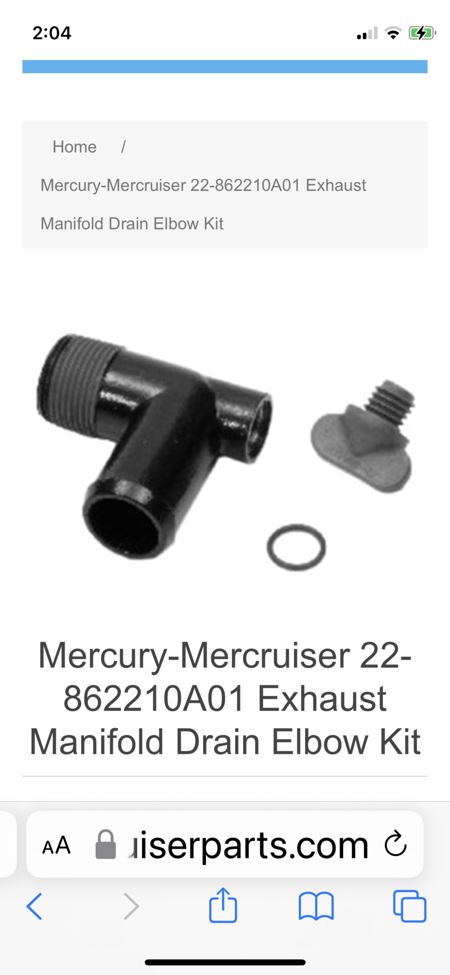

If you need either block adapter for blue plug or exh manifold elbow with blue pkug, they aren’t too expensive.
