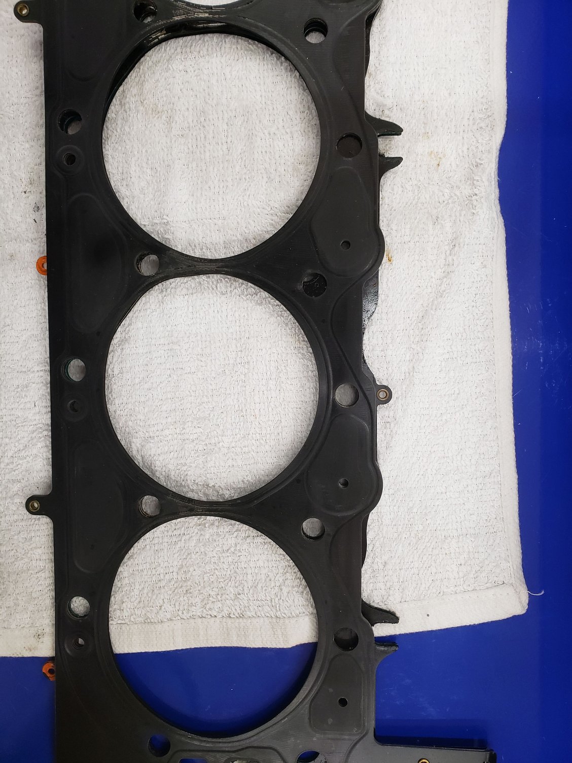

The Dart Gen VII block is available in SAE or Metric threads and uses the Gen VI timing cover and oil pan.
He would then drill the extra holes in the deck for the gen 7 heads to bolt up????
Other than the manifold?
And how far off is the Gen VII head bolt pattern compared to the Gen VI?
Is it just more bolts or is it a completely different pattern?

In response to bolting a gen 7 head onto an older block:
The gen 7 gasket is on the top, and lower gasket is from a bowtie block. I think I have these layed out correctly. Anyways, you can see a few holes would need to be drilled, but there are others "slightly off". I bet it could be done but man that's a lot of work. Especially plugging holes and redrilling them as they have slight overlap. Probably not worth it.
