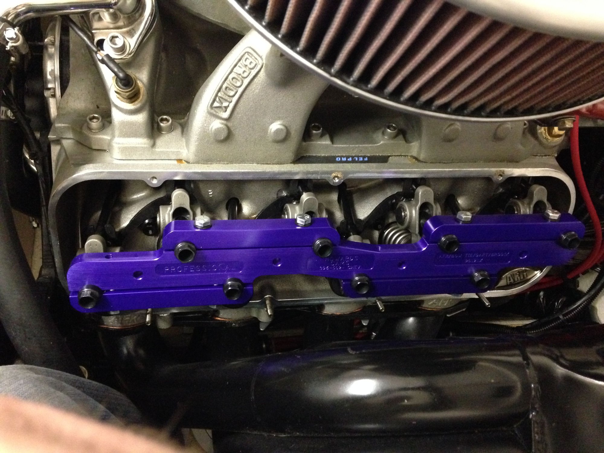

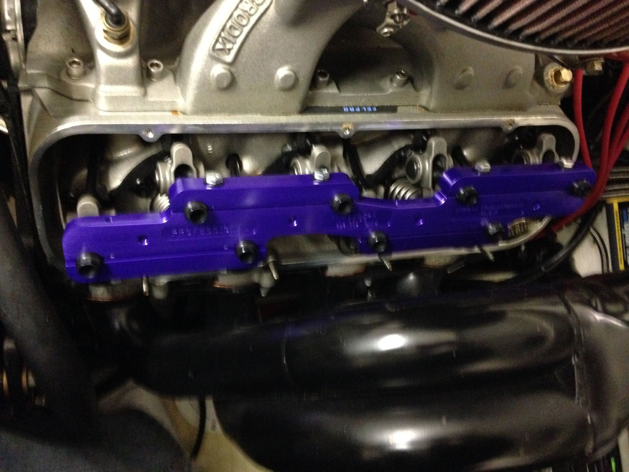

This is what I have done to stabilize my valve train. Crower Pro Magnum rockers, Isky 8205SP springs, ARP studs and a stud girdle.

Asking because I'm not familiar with either currently....do you get the same result if you run stud girdles vs running shaft rockers? Wondering advantages/disadvantages to either option?
Thanks!

No. Stud girdles a re a great budget way to help stabilize valvetrain. Nothing is a stable as good shaft mount rocker arms. TnD, Jesel, etc.
