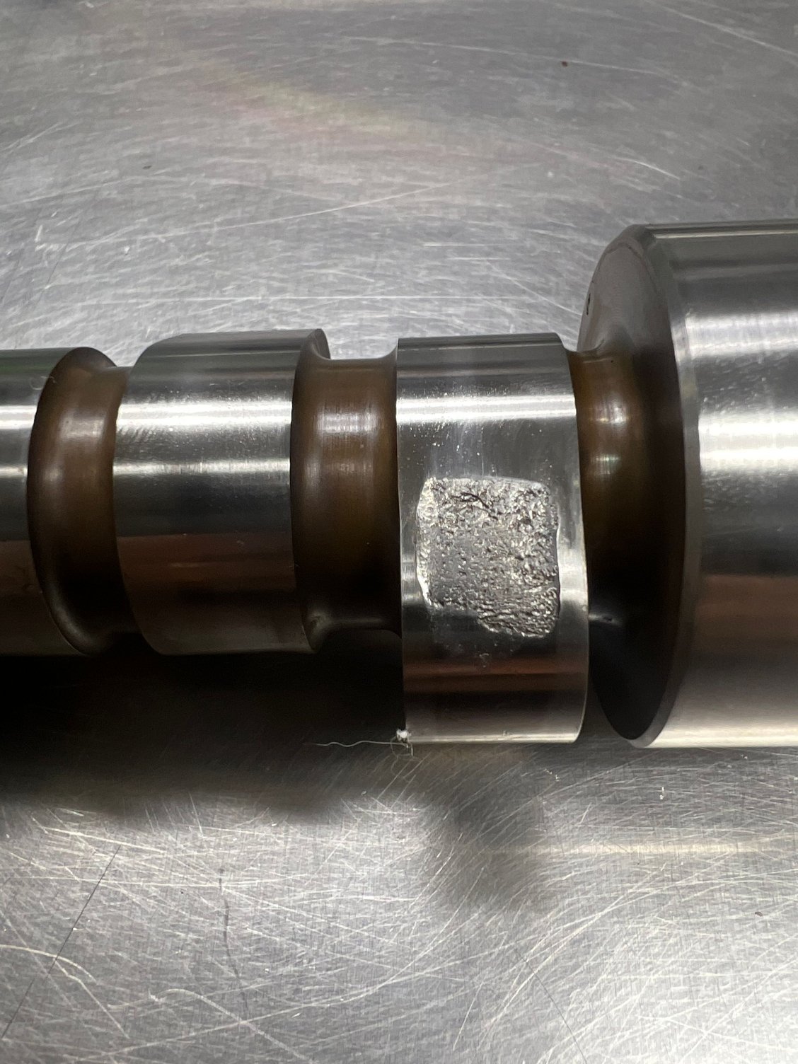

H20 Toie 03-27-2023 07:42 PM
Well motors are going back in this week,
Even thou it hurt having to listen to Mario at So-Cal Marine in Havasu tell me he wanted to take the motors apart i am sure glad i listened to him now,
i'm guessing that this would not have worked out in my favor in the long run
https://cimg0.ibsrv.net/gimg/www.off...db2e7b7eb.jpeg
Amazing what one part can do to the rest of the motor,
But soon to be reborn
https://cimg9.ibsrv.net/gimg/www.off...57a821c6d.jpeg
