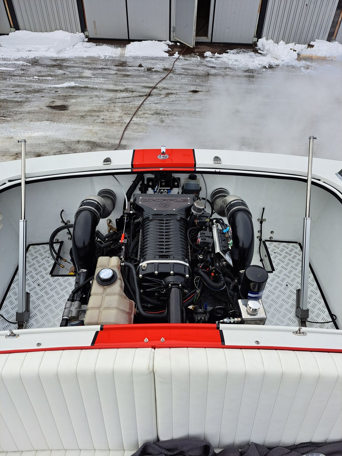

Guessing some of you will enjoy these pics.
Apparently my old engine broke last year, i tought only the headers cracked. But it was more. Decided to switch it up a little bit
Rerigged the boat myself, 2 full weekends and it was done, electrical, fuel lines, engine assembly etc, my wife was not happy with how much time i spent in the shop those 2 weekends, LOL.
496ho with whipple!
Second run (still adjusting fuelpressure, getting to know the hull at these speeds etc) i have done 74.3 knots, that is 85.5 mph. After 70 knots, it starts to chinewalk badly, so I need some seat-time to get to know the hull, but MAN does it get up and go.. now its a real hotrod! The acceleration is mind-blowing!
Bravo1 xr -2 sportmaster and a Bravo1 30P prop, for now.

I have a Donzi 1972 GT that I put a 496 HO in it with a Bravo. It run close to 70 MPH. How much HP do you think it makes more with the Whipple?
TYPHOON is offline
Old 04-20-2023 | 02:29 PM
Joined: Jul 2014
Posts: 51
Likes: 37
According to whipple, 625hp, so around 200 more.
However. Its running pretty rich, so its gonna make a little less than that. But ballpark 180-200hp more
