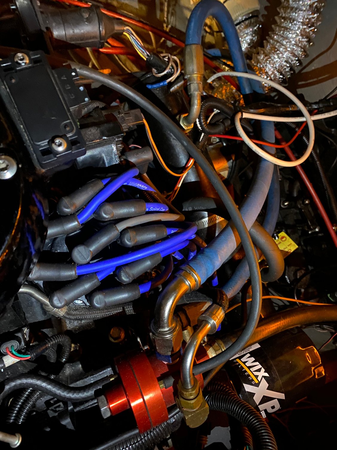

Originally Posted by compedgemarine (Post 4869337)
whole lot going on here but my first guess it that it had ProChargers on it that are now gone and if it was tuned that is what it was setup for. you have a vacuum hose with a screw in it, where is that going? it does not have a thermostat with that setup so it will struggle to make temp especially with all that fuel running thru it. not sure if that ecm is looking for water temp to go adjust it but odds are that alot was changed before you got it and they just made sure it would start so they could sell.
https://cimg9.ibsrv.net/gimg/www.off...125234055.jpeg
the plugged vacuum line goes to what appears to be a fuel regulator. Another line goes to the intake. Then it “looks” like the fuel lines run through a “log” that the water pumps water through? Is that correct and if so is that to warm the fuel?
sorry I built my first motor at 16, actively drag race etc but don’t know squat about marine MPI but love to learn
TIA!
articfriends 06-01-2023 10:40 PM
Make sure there is no ect modifyers between your temp sensor and harness, procharger used to supply those to trick ecm into getting extar fuel before anyone could tune mefis. Twin engine, they both do exactly same thing, mefi1 ecm or mefi 3?
SB 06-02-2023 04:45 AM
Originally Posted by CaptainChazz (Post 4869330)
Ahhhhh, picture is worth a thousand words.
Your engine had a procharger mounted.
Part of their package was a water crossover that replaced the factory circulation pump. Chances are no tstat , or one that was been drilled out because water needs to always flow to exhaust.
Your fuel system may have wrong psi’s for naturally aspirated fuel psi (ati’s FMU is still installed) and always possible someone has done ecu tuning.
